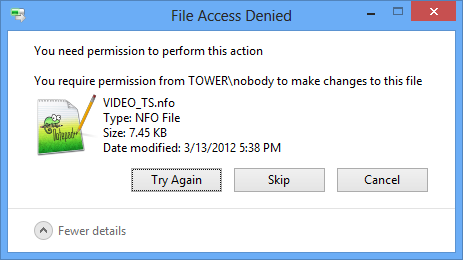

2. I am having permission issues deleting some files.  I get the error of "Permission required by TOWER\Nobody".  I have run the permissions utility twice but still the same issue.

Yes, I've run it twice already.  There's about 25 or so files I cannot delete in various folders...I've deleted a bunch others (same type/extension etc) without any issue...
