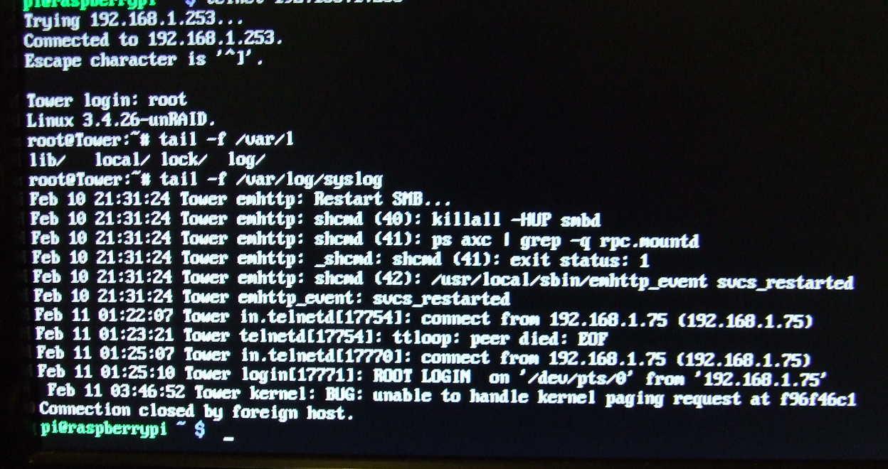

I finally manage to capture a syslog of the error occurring.
I apologise but I had no way of copying the contents of the console from my pi to my pc to post so I had to take a photo of the log.
After the last line my server became unresponsive.
Cheers.
