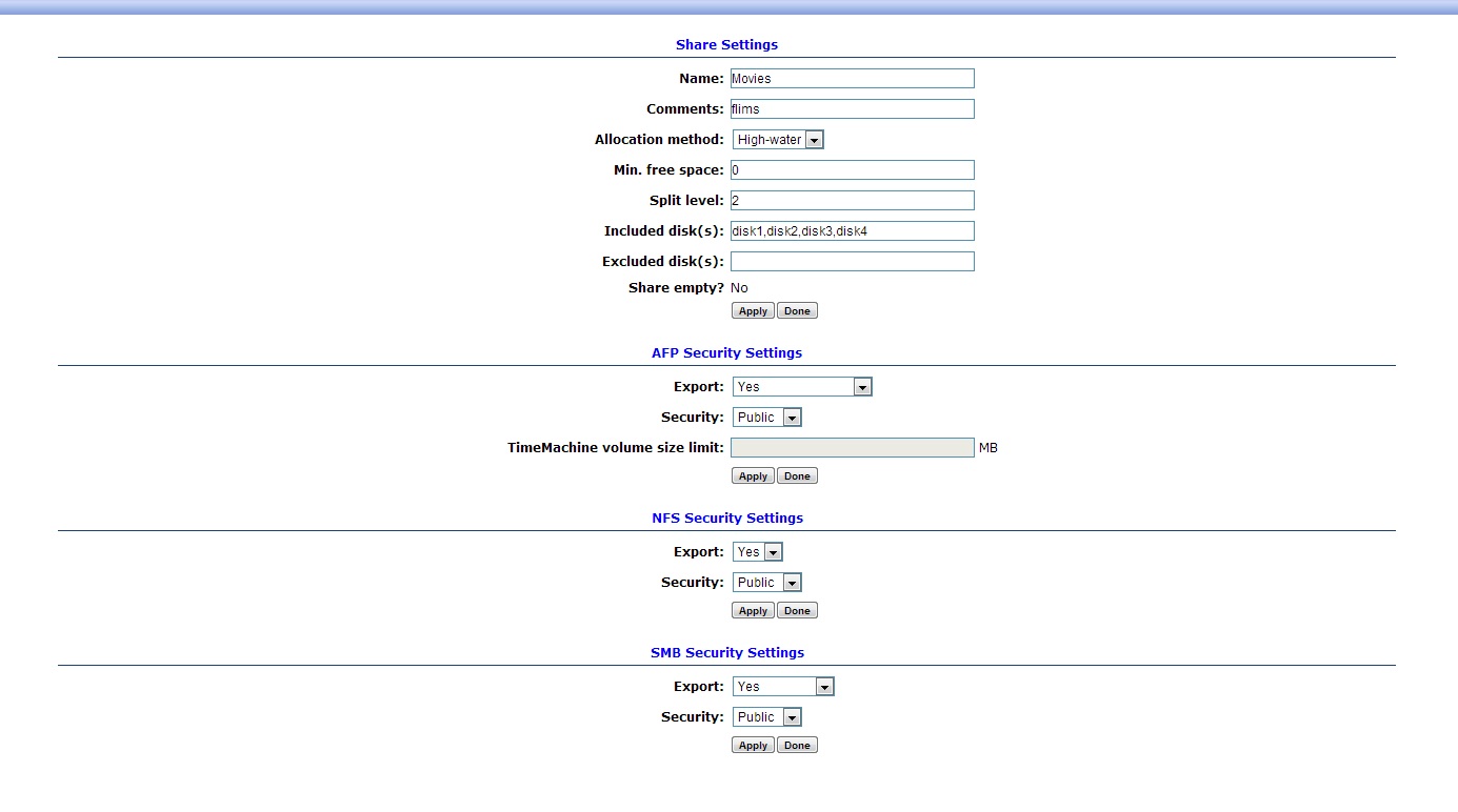

so went to me movies share and adding
disk1,disk2,disk3,disk4 to my included disk's
the extra space is not showing in the share folder area or within the windows 7 map network drive

Post screen shots of the specific share settings and Settings->Share Settings.
is this what you mean

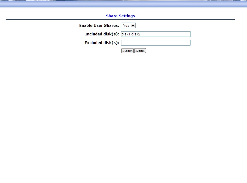

Yes. And the Share Settings config under the Settings tab.
found it here you go
I believe the "included disks" should be set to "All".  This allows all disks to be used for ANY share.  The first screen you posted is used to set which disks to be used for that particular share.
so simple swap disk1,disk2 to ALL dose it have be caps etc on the share settings
Mine is 'All' --- No quotes of course!  I do believe that a blank is equivalent to 'All' but I am not completely sure of that.
thanks so much have swap it to All like you and working now :)
