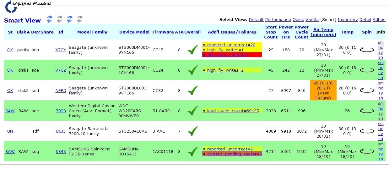

Just built my first sever after getting annoyed by my drobo. I brought 2 new 3tb drives and precleared them once each, but after looking at the SMART status i am rather worried.
I have attached a screen grab of what i am seeing and SMART reports.
I think my parity drive is not well, is this right?

Click on the sm link. When disk the last ATA error occur? Reseat or replace the SATA cable.
Hi, the errors all occured during a parity check
i will use a different sata cable just to make sure

This is an UNC error reported by the disk, not a CRC error detected by the disk controller or disk electronics.  A cable would not be the cause.
UNC = UN-Correctable read error of a sector
  (data on disk sector does not match its affiliated checksum at the end of the sector)
CRC = cyclic redundancy check on communications across the cable to/from the drive.
Get a "smart" report from the drive.  Odds are very high you have a sector pending re-allocation.

Hi Joe
There is a smart report attached to my initial post if this helps.
It shows 20 Reported_Uncorrected, which i assume is the same.

The SMART report was for disk1.  The the screen capture shows sector errors on the parity drive and /dev/sdg
Get smart reports for those drives.
I had the same errors on a Seagate 1T drive but not the same counts. Ran the disk for 4.5 years and replaced it still working. Run another check and see what happens with it.
I'd be more concerned about the pending sectors on sdg.
