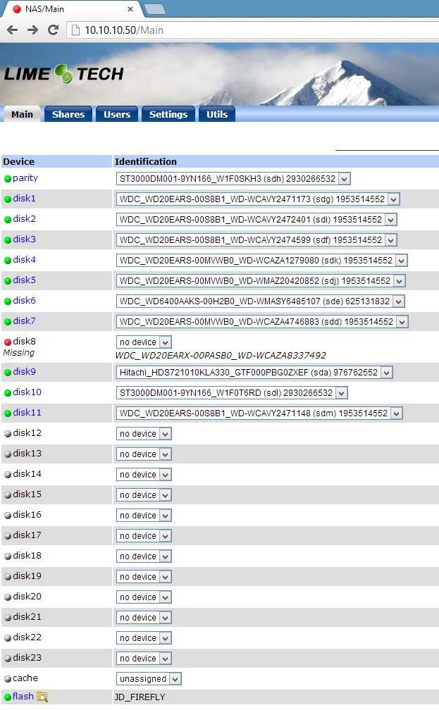

Scary situation (for me anyways).  My unRAID array won't come online and the whole system takes a good 5 min to boot up and the web interface is incredibly slow.  Take a couple minutes to navigate and took about 4 minutes to to log in AFTER I entered credentials.
I am afraid something bad is really happening.
Here is a screen shot and a syslog.  I know the screen shot says that disk8 is missing but it certainly is installed and the bios is detecting it so not sure where to go next.
I am of course freaking out a little.  Any help would be greatly appreciated.  Right now the I have NOT brought the array online

Here is the screenshot

I have found the harddrive that is going offline.  Turns out that by RAID controller lists the serials upon initializing so it made determining the physical drive much easier.
I have moved the drive to other controllers as well as reseated the cable and tested a new cable.  All with the same results.  I am going to go with the idea it is a bad HDD so I will get a replacement and update the thread once I do.
Again thanks all for the help and support thus far...I love this community we have here!
Well it looks like the HDD was bad...got a new one in and the array is rebuilding...disaster adverted...odd that the drive boots fine then fails
Oh well time for an RMA...thanks all!
