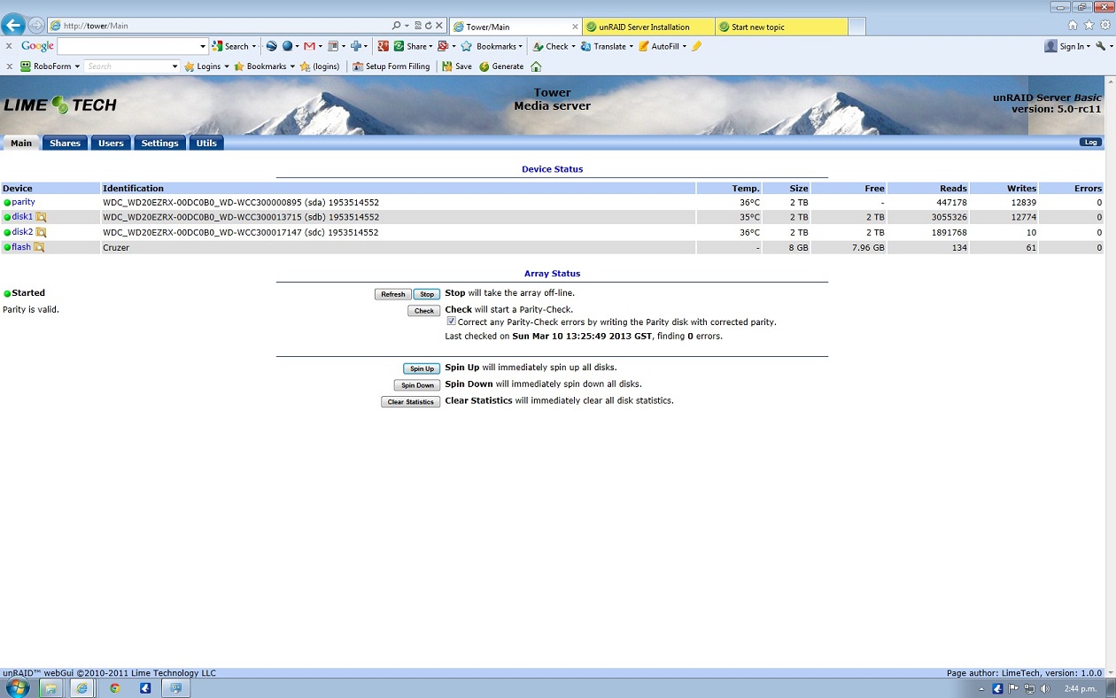

I [think] I have my system setup (2x2TB) data drives and a 2TB parity. It is hooked up to the network with all green lights.
As a test, I dragged and dropped a movie file from within win7 explorer onto the video folder I had setup in the share section of unRaid. I have no experience using Linux command lines so thought this may be an easy way out.

Have I set this up right for a start?  syslog and screen attached

How though do I actually see what is on the unRaid server? I can see that drive 1 is the only one being written to at the moment, but then again I have only moved about 100Gb of data across.
In Windows Explorer type "\\YourTower'sIP" in the address bar. That should show you all your disks, shares as well as flash drives.
Which disk gets filled how much and in what order depending on your allocation method, included/ excluded disks etc chosen in the particular share's settings. For instance, with 2TB drives and high-water allocation method you would need to fill up atleast 1TB on the drive currently being written to until unRAID starts writing to the second data disk.
