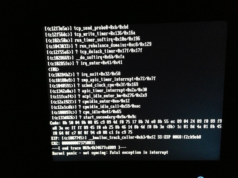

First I want to start by saying that I have been using Unraid for years without ANY issue, and I love it. So hats off to you guys for an awesome and stable release product!
The problems that I have had lately have been with the Beta5.0 rc12a version. I have experienced kernel panics when building parity 3 times in the past few days. Before updating to 5.0 I had 4.7 running and was able to build parity just fine. The strange thing is that every time this has happened has been sometime after midnight on all three occasions. Now the one thing that may be an issue is that I was using the array to stream content at these times. Also I am running plugins on the system and they where running as well. So this time I have shut down all Plugins and am trying parity check again. This takes a few days though. Does anyone have any thoughts on this one ?
Thanks guys !
System Specs are here. Also I have attached a image of the error.
11 Disks in the array at about 9.5 TB - on PCI Sata controllers
2TB Parity drive on the MB Sata ports
750GB Parity drive on the MB Sata ports
Intel i3 3.4GHz Sandy Bridge Proc
Foxconn H61AP MB
8GB Corsair CMP8GX3M2B1333C9 DDR3 1333 RAM
4- Promise SATA TXA300 controller Cards

Without any other details, the fact that your screen shot shows a memory "alloc" (allocation) at the end of the stack trace, might be a clue to indicate you ran out of free memory.
Joe L.
So maybe a bad memory module? I will run a memtest overnight and see what happens with that.
Could be that too, but I said not enough "free" memory.  (all available memory was already allocated to a running process)
Track via
free -l
Usually you will run out of "low" memory before anything else.
Joe L.
All those plugins can eat a lot of memory. Try disabling them, rebooting, and then building parity.
Ok so I disabled all the plugins yesterday morning when I did the first post. It was bilding parity all day and was fine. I checked it when I went to bed at 11pm last night and it was at about 40%. I woke up this morning and the same kernel panic happened. I am doing a mem test now and will check when I get home. I am at a loss here. It seems that this only happens after midnight.  :o
I guess I am reverting back to 4.7  :(. Unless anyone else has any ideas.
My 'Guess' would be that something is starting automatically around midnight which causes the kernel panic.  Why don't you print a copy of the disk setup (main page) and your share setups.  Back up your current flash drive so you can go back to  your current setup.  Double (and triple) check that you have a copy of your key file.

Failing 'sometime after midnight' makes me wonder whether mover is causing the system to topple over.

Is there a way to disable the mover completely for temporary testing ?
easy, just rename it so it is not found.
mv /usr/local/sbin/mover  /usr/local/sbin/mover.old

NOT /sbin,  but /usr/local/sbin

Sorry about that.  :P
Now the mover name is changed. I will give building a try again.
Wouldn't it be easier to go into Settings -> Share settings, and alter the schedule?
So it appears that the mover was the culprit ! After disabling the mover, parity has been building all night with no Kernel Panic. So I think there is something different about the mover in 5.0rc12a then 4.7. I did not have this issue in 4.7.
Also it appears that the Memtest version in the 5.0rc12a download is not the latest version from Memtest. Version 4.20 is on their site and supports Sandy Bridge CPUs. Memtest on the stick says version 4.10.
Thanks for the help guys !
