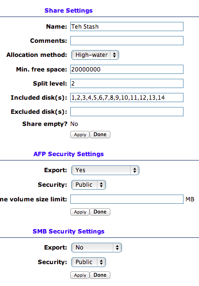

Trying to write a 1.85gb file to my share and it keeps writing to disk6 in the share with only 1.82 available, then i get the not enough free space error.  I have high water set and min space available set to 20gb.  See sys log and photo of share setup.

What is the path to the file in question?  You have a split level of 2 so only the first two folder levels can be split across disks.  Anything below that is constrained to the disk on which the third level folder is created.
So what would be the fix? setting my split level to 3? Or getting rid of the season folders because I have movies on the same share?
You have to set split levels according to how you want the system to allocate things across disks. There is no 'right' answer as it all depends on how you want to name things.  Note that you can change the split level on an existing share as it only applies to allocating space for new files/folders and does not affect the folders/files already there.

So my folder setup goes like this
movies > actual movie.mkv
tv shows > the show > season > episode1.mkv
and I have these on the same share.  I set my split level to 3 and got ride of the season folder for this problem and it fixed it.
So its a split level problem.
