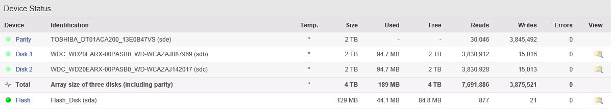

So I pre-cleared my drives, and formatted them. Then fired off the parity sync... I've got a bunch of writes on the parity disk... is that OK?
Absolutely -- you're doing a parity sync, so it's got to write EVERY byte on the parity disk  :)

Now clear your stats, and run a correctly parity check.  This time you should NOT see any writes, since parity should already be correct  :)

Pre-Clearing sets a pre-clear signature and zeroes an entire disk so that when it's added as a new data disk, the parity computation isn't changed (i.e. if you're adding up a longitudinal parity, a zero doesn't change the result).  But that's definitely NOT how the parity disk needs to start off  :)
actually had an accidental shutdown from console without stopping array - so let the parity check run after reboot, and indeed no writes. mostly reads.
