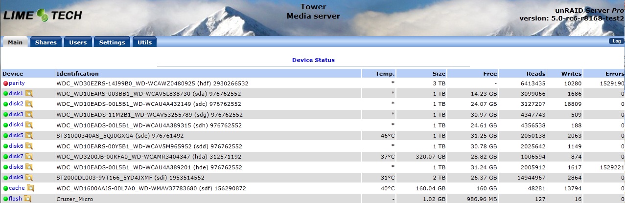

In the last few days I noticed that my Unraid array had very poor write performance. Further investigation suggested that the cache disc wasn't being used. I was preparing to upgrade to latest RC, but a reboot seemed to rectify. I then tried to transfer some new files to the array and recieved a weired IO error from Win7 (which I have not been unable to reproduce to grab a pic).
I was able to write a couple of files directly to disk shares (not user shares), but this was hit and miss. I went back to the web console (which previously showed no issues), and now I see this (attached):
Im 99% sure that disk 8 (with shows as having a heap of errors) had a red ball for a small period (despite being green in the attached image).
I'll post a log when I can, but any thoughts/suggestions would be greatly appreciated!!!
Something is clearly wrong, but you'll need a Linux expert to jump in with some ideas as to just why => but Parity, disk7, and disk8 are showing with hd.. designations instead of the sd... they should be showing.    Are these drives on a different controller than the rest?
Further, your parity is not good, so your recover options are limited.
It would help understand what may have gone wrong if you could provide more details about what actions you've recently take on this system.  [Version upgrade; internal cabling changes; etc.]
... as for the question you asked in the title [should I be worried?] ==> YES, something is clearly wrong and could result in (a) an unprotected array or (b) loss of data (on at least one drive).
Hope for (a)  :)

I do not know why 3 of your drives (including parity) have hdx designations -- they should all be sdx as far as I know.    Does your system have multiple SATA controllers -- and, if so, is there any chance you've changed the settings for one of them in the BIOS (perhaps to IDE legacy mode)?

You have the BIOS setting for that set of ports in IDE mode (or legacy mode) rather than AHCI mode as it should be for SATA drives.  Many BIOS come that way as Windows XP and prior had no saTA drivers, and if a purchaser tried to boot XP, it would not find any drives unless set to emulated legacy mode.
The emulated mode is often slower, so set it correctly and you;ll have less issues.
