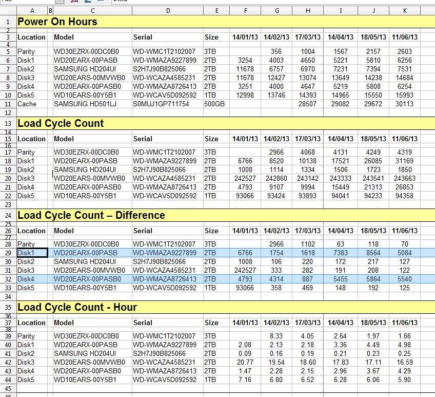

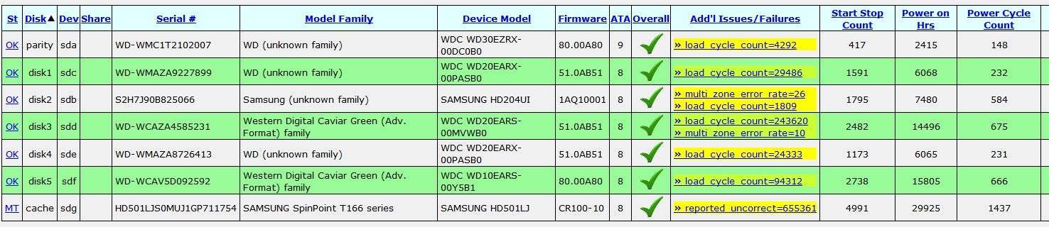

Hi
Well I've been measuring my LCC's for about 6 months  now and have the results in the attached  screen shot.
What's surprising to me is that the 2x WD20EARX drives over the last 3 months seem to be hitting 5000 LCC's plus a month.
All the WD drives have WDIDEL3 /300 set on them, is it worth disabling the timer with /D on the 2x WD20EARX drives?
