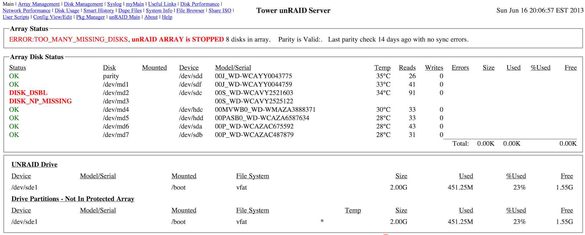

I was using my UnRAID today and after folders not responding in my finder discovered that disk2 had a red ball next to it in the main Web interface. The steps I followed after this discovery were:
1. Stopped the Array using Web GUI
2. Powerdown the Array using Web GUI
3. Ejected and re-seated the Disk caddies / opened case and verified cabling.
4. Powered UnRAID server back on.
After this I notice that there was now two drives (disk2 and disk 3) showing red ball faults. See attached Screen Shot. I continued powering down the array and re-seating drives, moved the drives to other spare slots to eliminate the cabling (sata + power) as the source of the issue.
I am able to see disk2 and run a SMART test on it. I ran the short SMART test and it came up with no errors.
I have a feeling disk3 is dead. I am hoping some kind person could guide me through the process of getting at least disk2 working enough so I can replace and rebuild disk3. I am hoping I have not lost 4TB of data :(.

Your system has removed Disk #2 from the array due to errors; and does not SEE Disk #2 (the disk is "Not Present").    Be sure both the data cable and power cable is securely seated on Disk #3 (do this with power off).  Then reboot the array and see if #3 comes back online.  If so, you'll be able to replaced Disk #2 with a spare and it will rebuild it.  Since the drives are in a caddy, you can first try just removing and re-inserting Disk #3;  but if that doesn't work, I'd mount it internally with direct cables just to be sure the connections on the caddy aren't bad.

I have tried bypassing the caddy for dsk3 to no avail. The dsk3 is not spinning up at all. Its not being seen in the BIOS. I have six onboard SATA and 2x Adaptec Cards with 4 more SATA each. I have tried the drive on both the motherboard SATA connections and the Adaptec cards.
I feel there is more chance of getting dsk2 working than dsk3. I am going to run a long SMART test on dsk2 to see what errors I get. Do you think this is wise? I will post the results of this test.
On the screen shot do you know what drive is saying that it is vfat? dsk2 still says it is RieserFS in the Web GUI.

If Disk3 has failed to the point where it's not even spinning, then you're pretty much "hosed."
Unless Disk2 magically comes back on line ... which I suppose COULD happen -- but I don't believe UnRAID will restore a disk after it's removed it from the array.
Are you SURE Disk3 isn't spinning?    If you hook up the power connection (no data connector), can you feel any vibration if you hold it in your hand?    You should (if it's spinning) also feel a bit of gyroscopic resistance if you "rotate" it a bit.
But if it's dead, and #2 has also failed, there's really nothing you can do -- the contents of both drives are simply gone.  You CAN connect them to another system (perhaps a PC) and see if you can read the data independently (using the free Linux Reader so the Windows system can "see" the file system).
