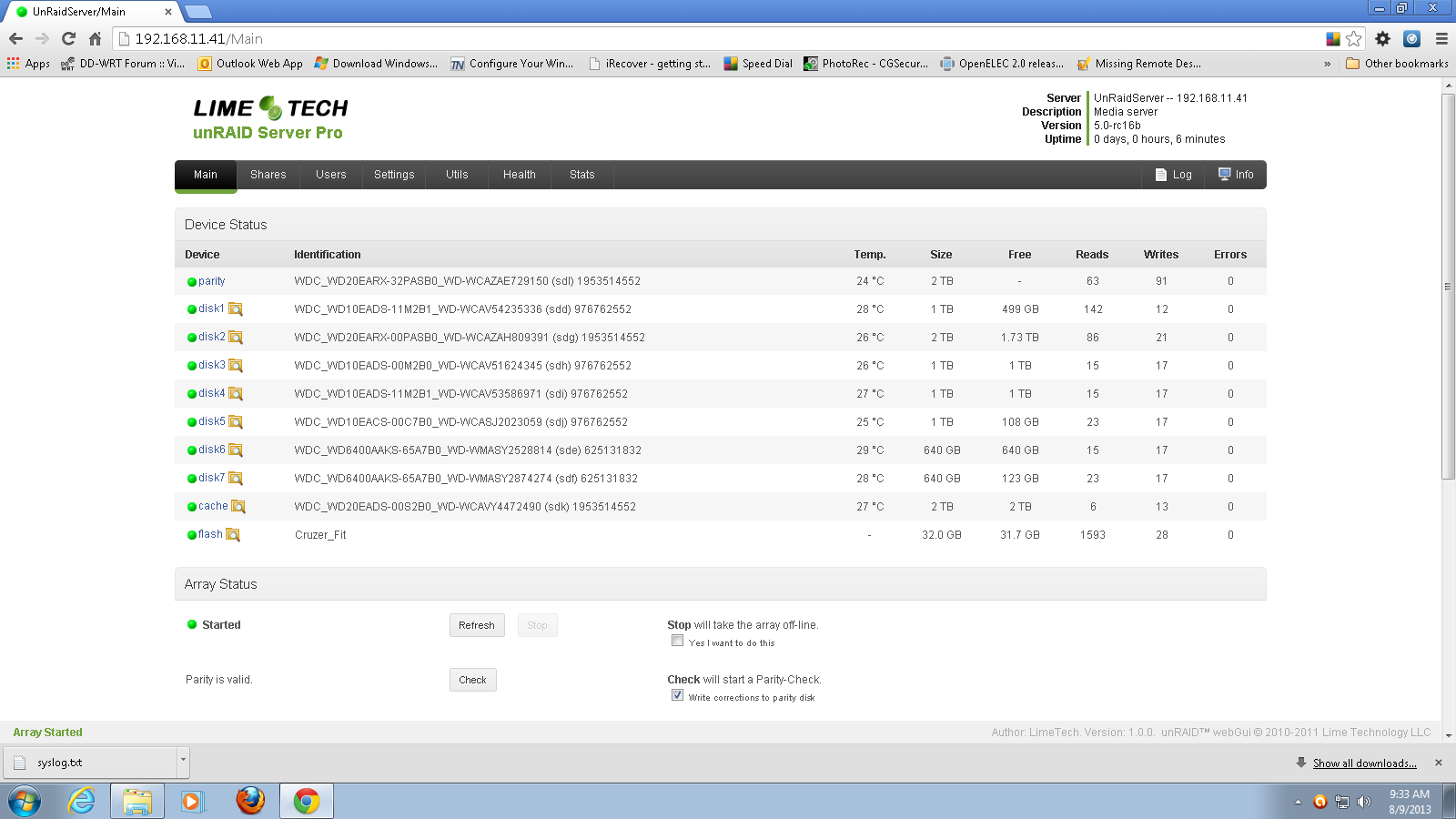

August 9, 201313 yr Author And here are the image of the before the drive change when everything was working fine.

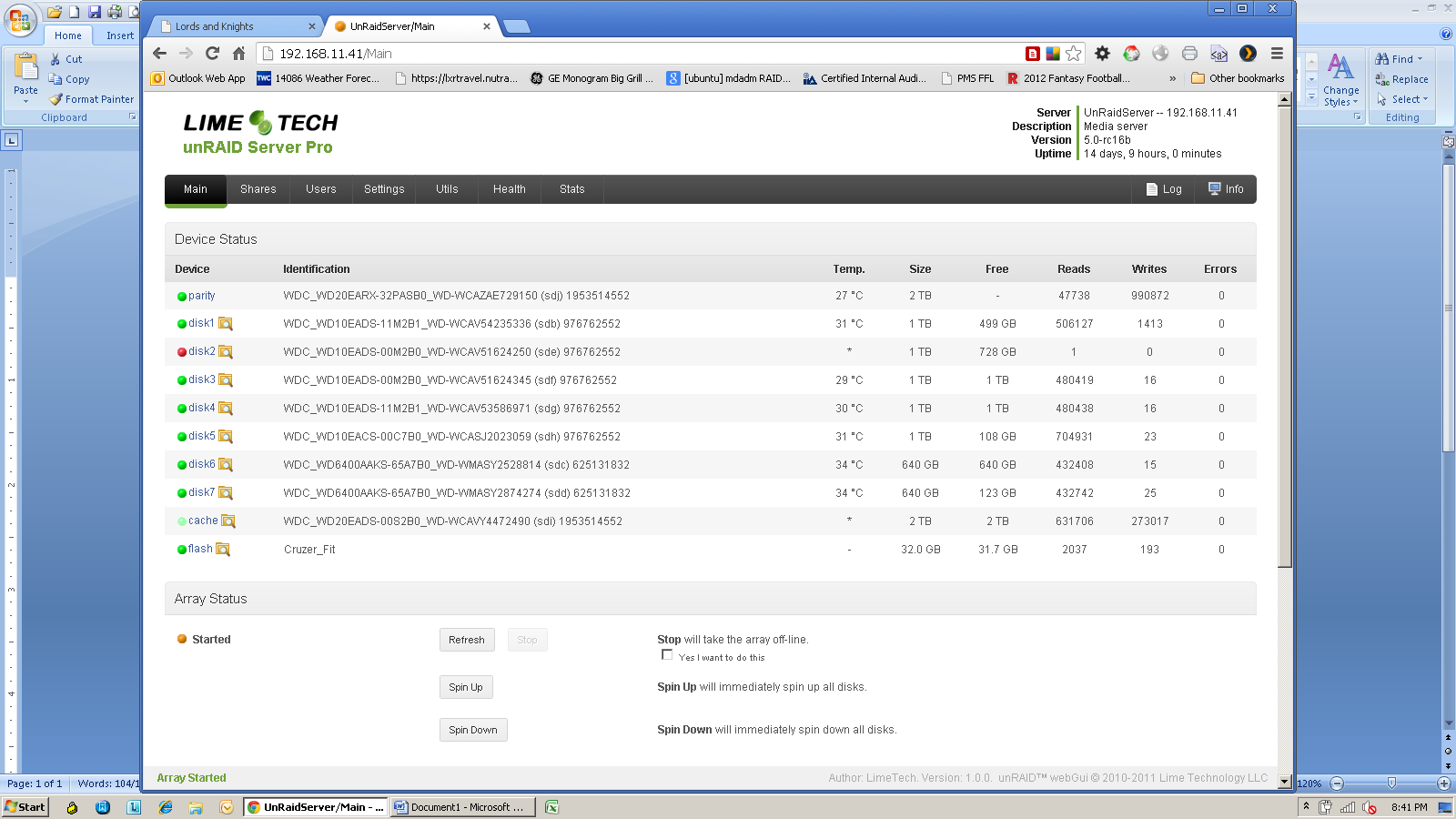

August 9, 201313 yr Author And this is the post screen shot today that also appears ok, but I'm missing all my data.
