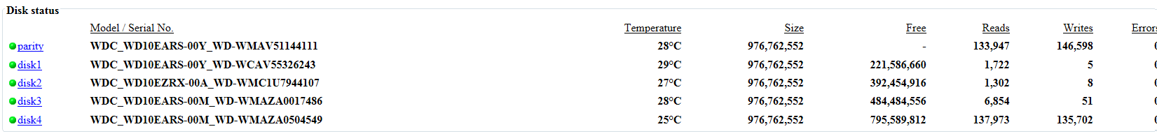

So, some disks are fuller than others. In the case of the one that is being written to now, it's only about 15-20% full  (attaching pic, it would be disk 4).
I just tried writing to the disk (i.e. share: \\Tower\disk4\TV Shows) with the same result, a very short initial burst of about 20MB/s to quickly fall back to about 10MB/s... :(
