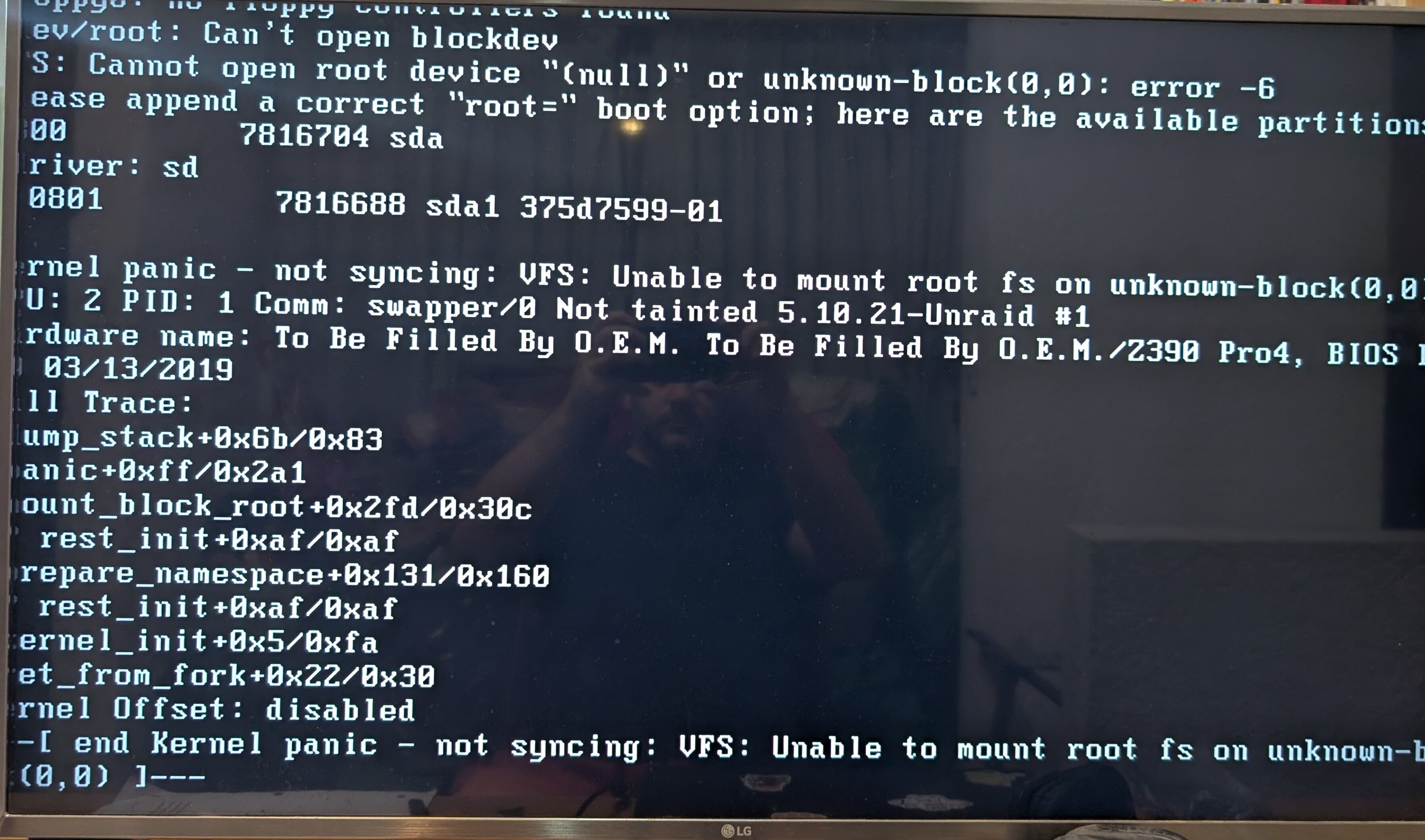

  4. Hi folks, I had my server up and running for several years, but I have a problem now where it's not booting... It first happened a few days ago, and when it did I unplugged the USB drive, plugged it to a different port and it did boot up, but now it's happening again... I just plugged the drive into my PC and it is "working", and I backed up all files (again) just in case. Is this something I can troubleshoot or is it likely the drive? Should I try formatting it and re-copying the files again (don't remember after so long if there was something else that needed to be done to "prepare" the drive), and lastly should I need to replace the drive, is it still the case these are tied to the drive ID etc, and if so what do I need to do so that my license will still be valid? (I have an old "Pro Key"). Thanks for your help.
