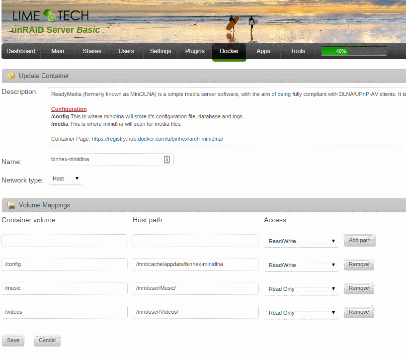

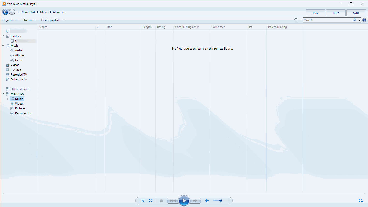

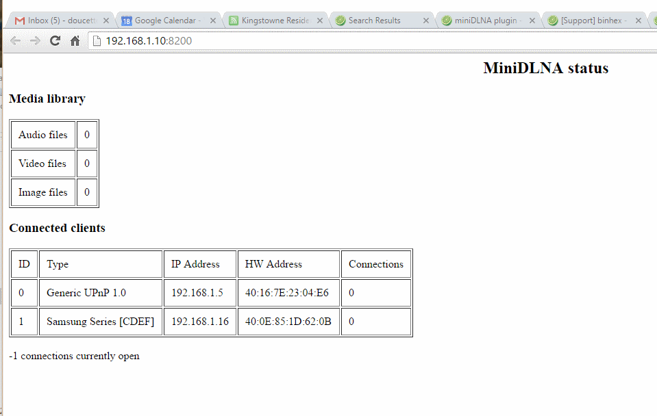

How do I get minidlna to refresh the media? I have enabled it in docker, restarted it, and while my devices see it, they do not see any media.
I have attached screenshots of my docker minidlna setup and of the webpage it gives me.
Thank you,
Ari
Thank you,
Ari
This docker has been created to use /media, if you want to do what you have specified then you will need to modify the minidlna config file located in /config and change the location for media from /media to your locations /music and /videos
