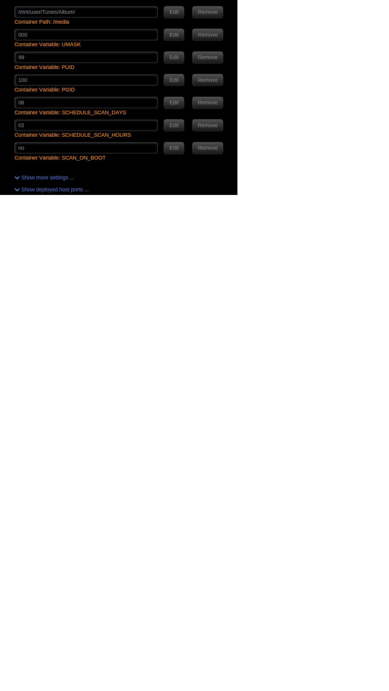

  13. Are these typo`s kolla? check your directory inputs its mnt(mount) once miniDLNA starts scanning you will see the files.db grow (located in the appdata binhex-miniDLNA folder) & the artwork folder starts to populate. Perhaps you could start again, uninstall minidlna then run the plugin CA cleanup appdata to wipe whats remaining of the docker. Pull the docker down again and set the correct directory where your files are located.
  14. I have not used miniDLNA for awhile so i pulled down the latest docker image. I left everything default other than changing where the docker should look for my music directory. which is /mnt/user/Tunes/Album It is now scanning all my files including artwork. So it would seem editing the .conf file is no longer needed
