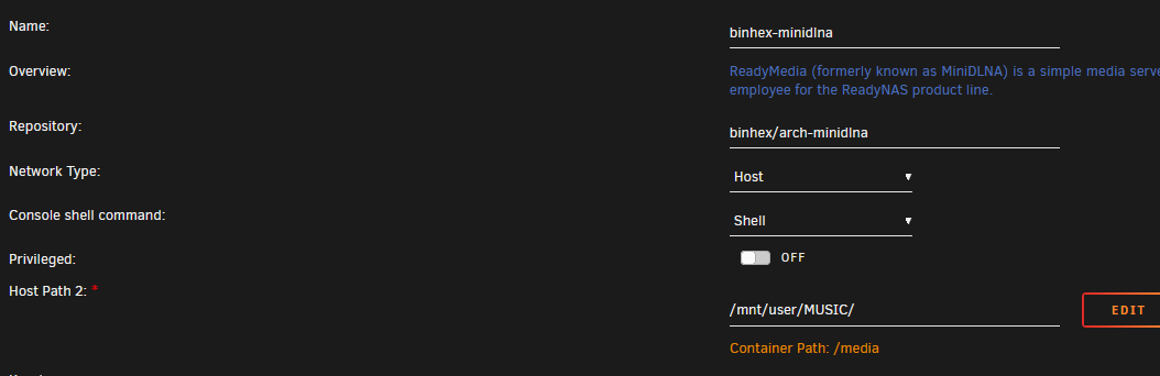

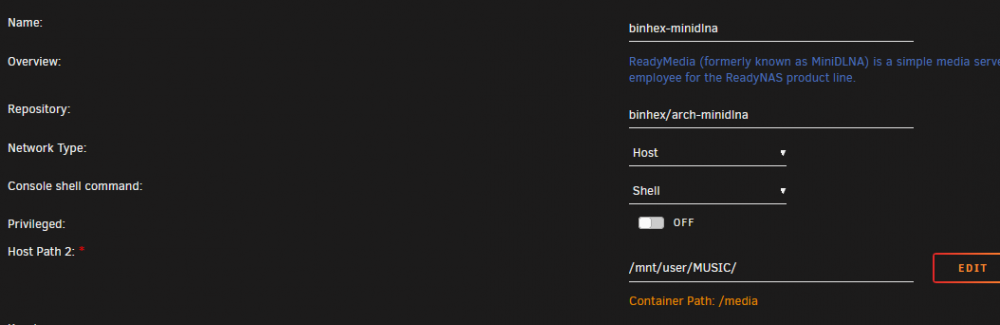

I'm really struggling setting the config for this. My media is here: /mnt/user/MUSIC/ and I've set it to that within unraid and checked that minidnla.conf shows that too. It's not found anything though.
What am I doing wrong? Thanks
On 5/15/2021 at 4:46 PM, be4con said:
/mnt/user/MUSIC/
ok first question, is your share name really 'MUSIC'? are you 100% positive on the case, its not 'Music' or 'music' right?, because linux is CaSe sensitive.
assuming you do have a share of MUSIC, make sure you are telling miniDLNA to look at /media NOT /mnt/user/MUSIC, as this does not exist INSIDE the container.

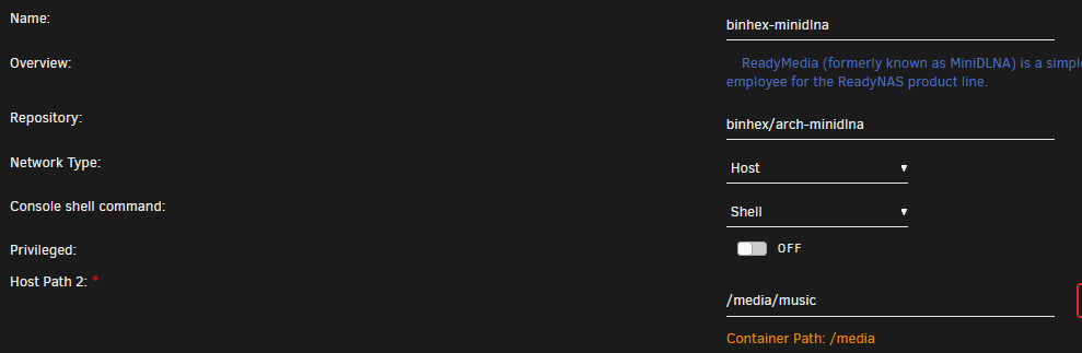

In the log it states: "[2021/05/20 15:49:00] minidlna.c:670: error: Media directory "/mnt/user/MUSIC" not accessible [No such file or directory]"
So, it is a problem with the share, but I don't understand what I need to change. This is my share:

looks like you have changed the host path for the worse since your initial screenshot, it now shows this which is wrong:-
it should be as you had it, i.e.:-
looks like the config file is also incorrect, from your post above:-
this is not correct, it should be set to:-
media_dir=/media
as per the default file.
Ah, the Host path is me messing with different options to see if anything worked - thought I'd changed it back before I took the screenshot. Apparently not.
For the config fille - what's all the gubbins about changing the path mean then? I thought I had just followed the instructions in the file itself.
OK, having changed that it is now finding files! Thanks for working through that with me.

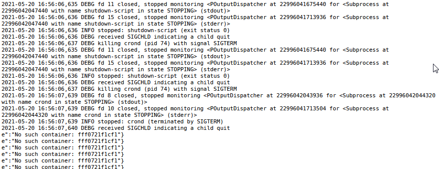

I've just noticed multiple occurrences of this message appearing in my system log:
