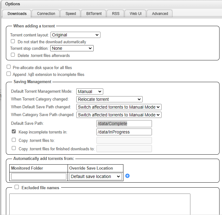

  4. Inside Qbittorrent's settings, my downloads are set to: The directory looks to be mapped properly. Only other thing I fiddled with is the polling time and the disk cache settings under advanced. I added a bit more memory and set the refresh interval to 2000ms, the disk queue size to 1024kb, oh, and the max active torrents to 6. I wouldn't expect these to cause a problem.
