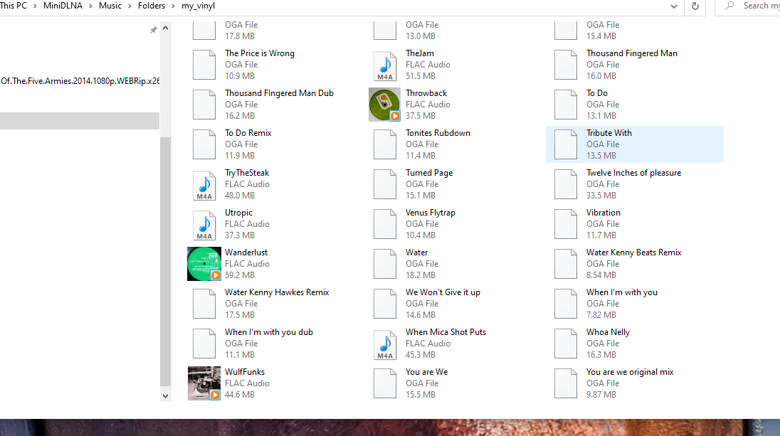

I too am having issues configuring MiniDLNA. I'm new to UNRAID and recently set it up. The main reason for me to get a home server is to get a DLNA server going so I can play music on my stereo. I looked for documentation on the project page and it's non existent, so I'm trying to make educated guesses from reading these forums. I got into the config file and have a few questions. You can run this as a user. Is this necessary? The default is "nobody". As a test, I created a user "minidlna" and set that as my user to run the server as. This returns a fatal "bad user" error and the server doesn't launch. Also, I'm having trouble adding an extra media directory to the default directory. In my config file, I have: media_dir=/media media_dir=/mnt/user/podcasts/ When I restart my server: It clearly doesn't like this share. Am I not entering the right path? I have a share called podcasts I'd like to add and it's located on my array under /mnt/user/podcasts.... Why is MiniDLNA returning it as not accessible? Also, does MiniDLNA support .ogg Vorbis? The DLNA spec does, as far as I know. I have thousands of .ogg files. When I connect a player like mediaMonkey to my miniDLNA, the ogg files do not get played, they get greyed out and skipped. FLAC and MP3 work fine, album art gets loaded.... Browsing the folders served by miniDLNA in my windows explorer I see that the file type is not correctly identified. FLAC is showing correctly, but not the OGG. The latter shows incorrectly as an "OGA" file.
