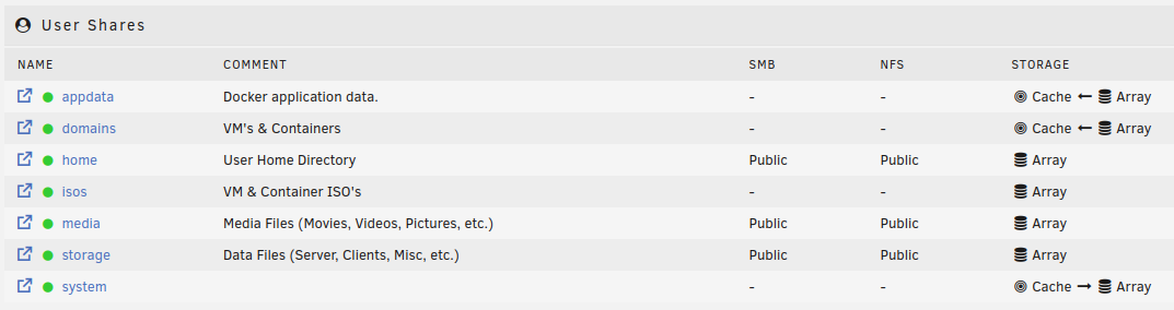

why cant i get it to work?
Simply ran the container, cant get to 8200, nor can i get vlc or my denon heos app to find it.
I tried adding port 8200 manually, but to no avail.
the 'network type' should be set to 'bridge' is this the case? the reason i ask is that in bridge mode you do not specify ports.
it was set to host. Doesn't work both ways. either bridge or host...
Also, nothing is listening on port 8200 on my unraid server when the container is running...

UPDATE: SOLVED (see below):
Greetings...
I've been using MiniDLNA for a few years now, and specifically in UNRAID since installing in Feb. of 2023 when I first started using UNRAID. It seems to be the only DLNA server that just shows up in everything that I use, Roku Media Player, LG Smart TV's, VLC under Shield, and Linux, etc., without needing configuration.
However, something has changed recently and the only thing that I have done is upgrade to the newest version of UNRAID.
The MiniDLNA server still shows up on all devices however it is no longer seeing any of my media. The Roku Media Server states that it did not find any compatible media, here is what VLC shows, just no media:
I've tried stopping the container and modified the config file; both by changing the `/media` path to `/mnt/user/media` and just setting the paths in the Docker GUI to `/Movies` for example and actually specifying the folder paths in the config file.
No matter what I change it to, the Docker Logs give the following error in all cases:
    [2024/08/22 09:02:38] minidlna.c:669: error: Media directory "/media" not accessible [No such file or directory]
    [2024/08/22 09:09:20] minidlna.c:669: error: Media directory "V,/mnt/user/media/Movies" not accessible [No such file or directory]
    [2024/08/22 09:09:20] minidlna.c:669: error: Media directory "V,/mnt/user/media/Videos" not accessible [No such file or directory]
    [2024/08/22 09:09:20] minidlna.c:669: error: Media directory "A,/mnt/user/media/Music" not accessible [No such file or directory]
    [2024/08/22 09:09:20] minidlna.c:669: error: Media directory "A,/mnt/user/media/Podcast" not accessible [No such file or directory]
    [2024/08/22 09:09:20] minidlna.c:669: error: Media directory "P,/mnt/user/media/Pictures" not accessible [No such file or directory]
    [2024/08/22 10:17:39] minidlna.c:669: error: Media directory "/mnt/user/media" not accessible [No such file or directory]
...see attached file:
2024-08-22_MiniDLNA-Data.txt
The location of the share is correct and set to public, so there should not be any permission issues:
Any advise appreciated.
Also...
From the initial install, MiniDLNA has always been set as a `Host` if set to `Bridge` it does not show up in any devices.
UPDATE:
It seems that I did make a slight change to my system after all.
My cache drives were separate, and I had pooled them together for redundancy. I had set the `appdata` folder to be moved/stored on the cache drive pool. While it didn't seem to affect any other containers, MiniDLNA didn't seem to care for it. Once I reversed that and had the `appdata` folder go back to the array, MiniDLNA once again was able to find the media folder and is working just fine now.
Edited by AgentEccks
adding info RE `Host` and `Bridge`
