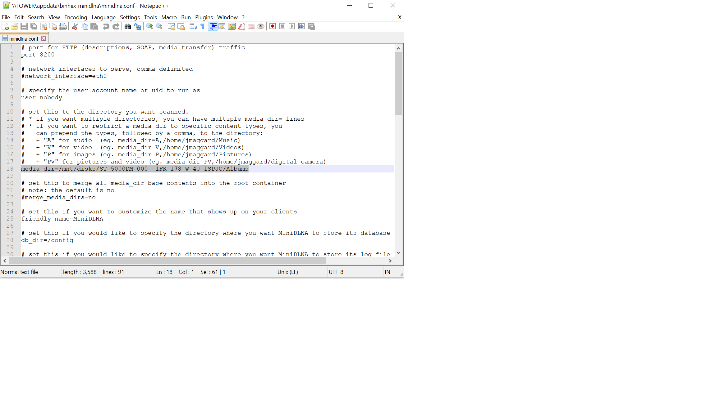

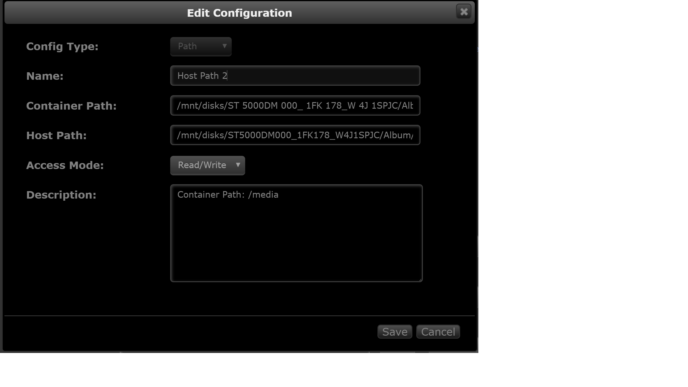

I need some help with getting minidlna to work with my client. There are no files listed by my dlna app, and I'm thinking I don't have my path properly described. I am not at all knowledgeable about the pathing syntax Linux uses. My user share (Movies) is a collection of The contents of my disk shares. The path I entered for Host Path on the setup page is: /mnt/user/Movies/. I also edited the config file to match this entry. This path description is obviously just a guess
Note: I don't know if this information is needed, but the name of my unraid box is "Tower."
I have tried various other path descriptions, but all have been unsuccessful. I would appreciate any help with this.
Edited by Two Wire
@Two Wire
This configuration is working for me, you will see your cpu/memory usage shoot up when initial scan takes place. Include the full path to the dir/share you want scanned in both container path and host path also the minidlna.conf
Edited by raidserver
