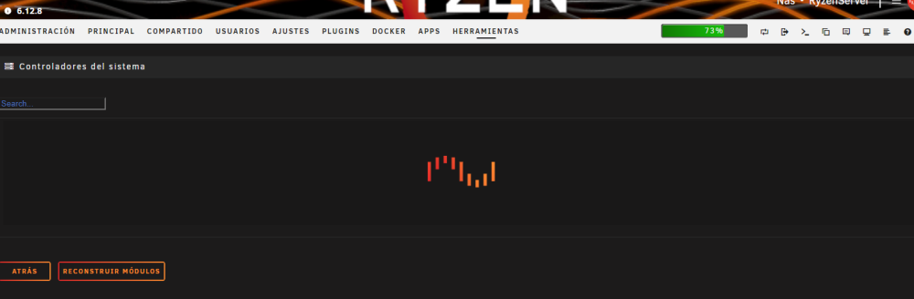

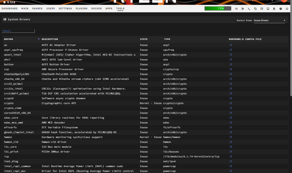

Smooth update.  Thanks for the good work!
1100050888_DesktopScreenshot2024_02.16-05_51_47_100.thumb.png.77ddda66edef29ef169568c70fab8c44.png
440905137_DesktopScreenshot2024_02.16-05_50_41_55.thumb.png.07765f13296f3d54616168dea25ddd13.png
im gonna press X to doubt :P

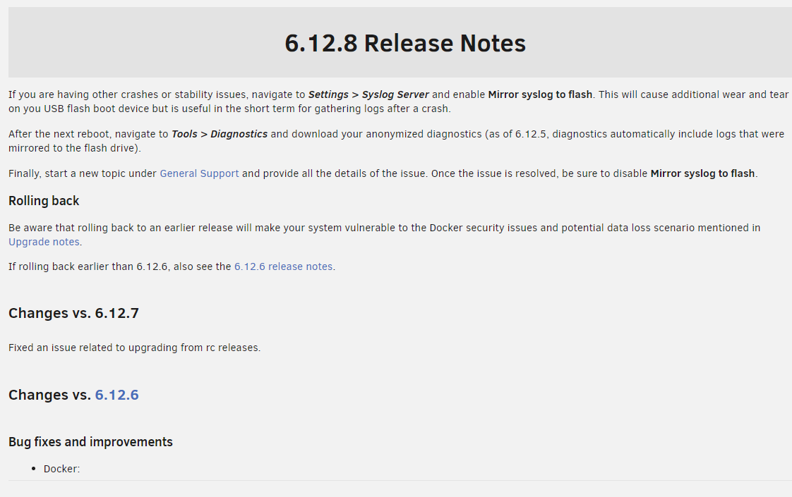

Changes vs. 6.12.7
Fixed an issue related to upgrading from rc releases
That I found in the Documentation.

No package updates this time? No new kernel version?
Possibly you missed the changes vs 6.12.6 from the release notes:
Package updates
docker: version 24.0.9
kernel-firmware: version 20231226_abfcad8
Linux kernel
version 6.1.74
Oops my fault. I didn't read beyond the "Changes since 6.12.7" header.
Sorry.
