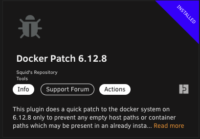

I'd recommend to install the Docker Patch 6.12.8 from Apps due to docker now treating as an error a common mistake that users may have made (leaving unused paths empty on the template) when installing from Apps.  It's not a bug in the OS, but now docker enforcing their specification on the run command

  • I'd recommend to install the Docker Patch 6.12.8 from Apps due to docker now treating as an error a common mistake that users may have made (leaving unused paths empty on the template) when installing

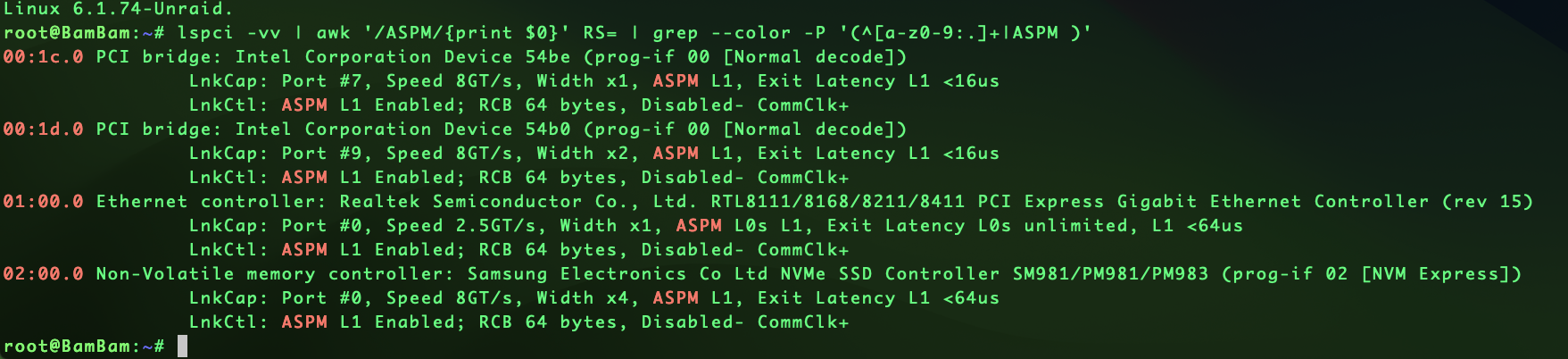

  • I was now able to activate ASPM for Realtek Network Devices again with 6.12.8 by activating ASPM manually.   This commands I used: sudo setpci -s 00:1c.0 0x50.B=0x42 sudo setpci -s
  • Depends upon your point of view.   Since 2015, I've never even considered leaving an "empty" path on any docker template and instead of simply deleted the path from the template.
With 6.12.8, docker is now enforcing a specification and returning an error if you left an empty path on a template when installing it or updating it.   Since there is already a number of users with this issue (self-caused), the plugin is changing how the docker run command gets generated to ignore this problem.
There is NO bug with the OS.  There is NO bug with docker.  The plugin lowers support requests in the forum on what the issue is when all of a sudden they update their containers and they disappear.
You don't need the plugin if you have no templates with empty paths and always delete any empty paths on new installations from CA.

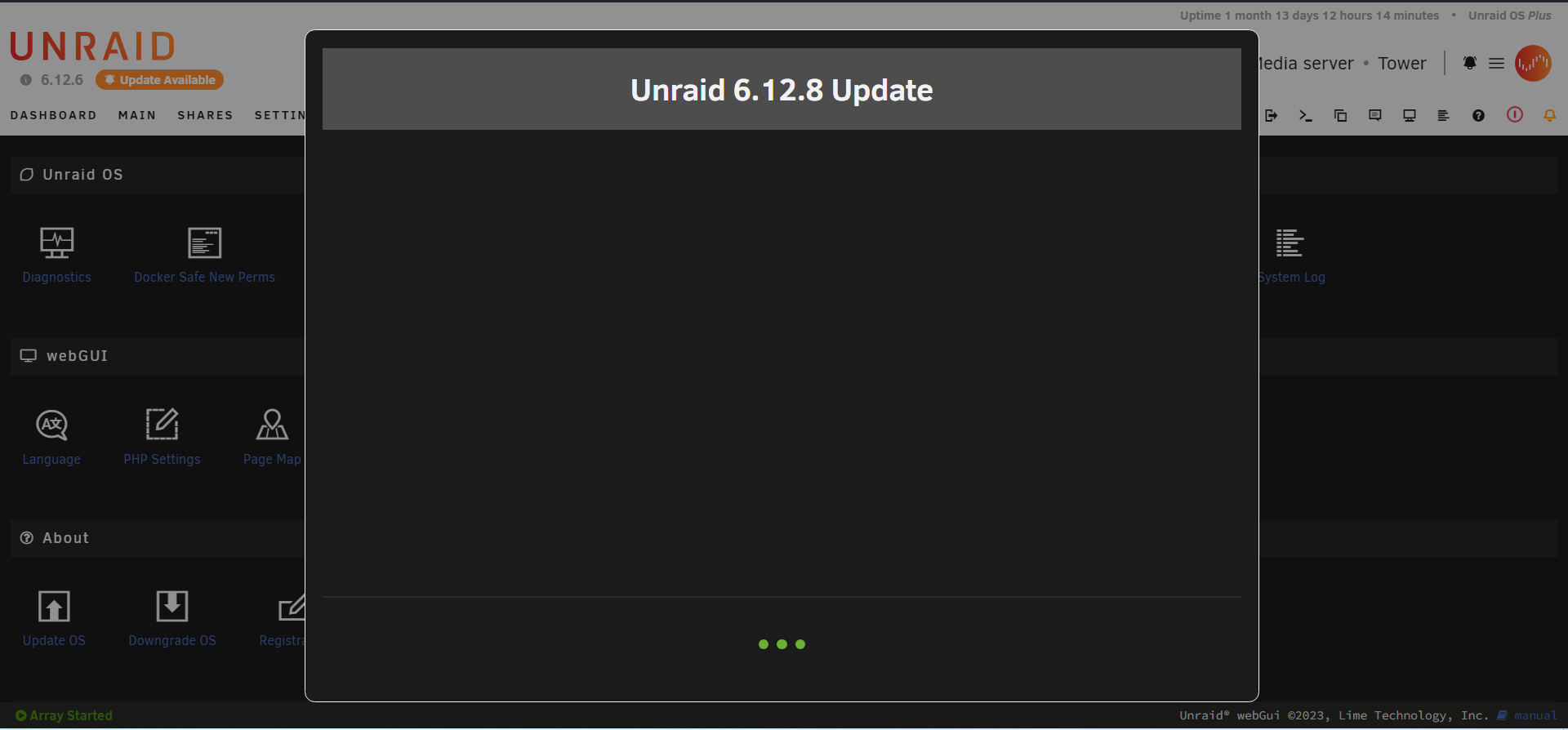

Update got stuck on this:
Left it for about 5 minutes and it was still there. It wasn't until I checked notifications on my phone that I saw everything had updated and to reboot.

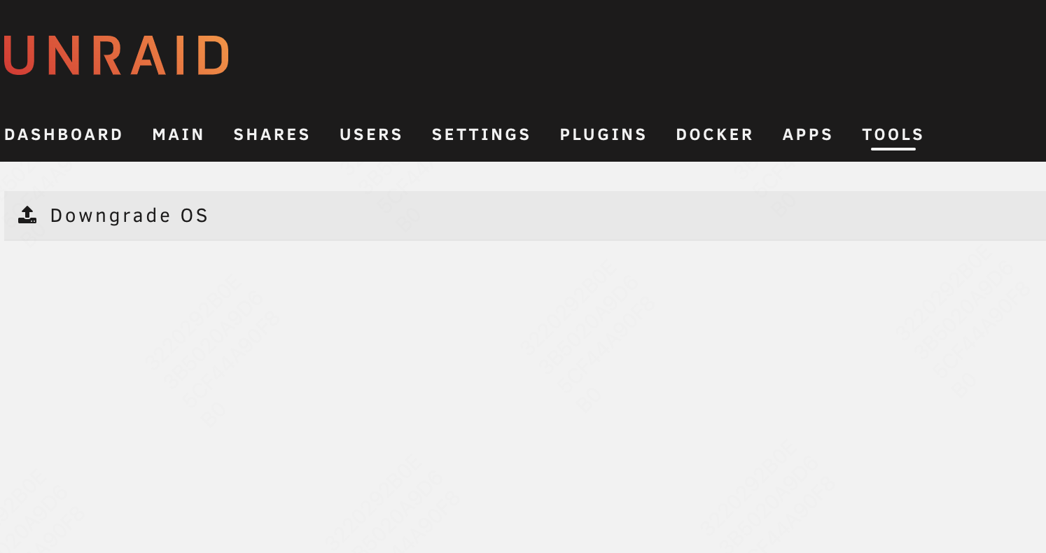

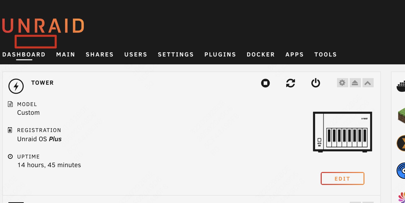

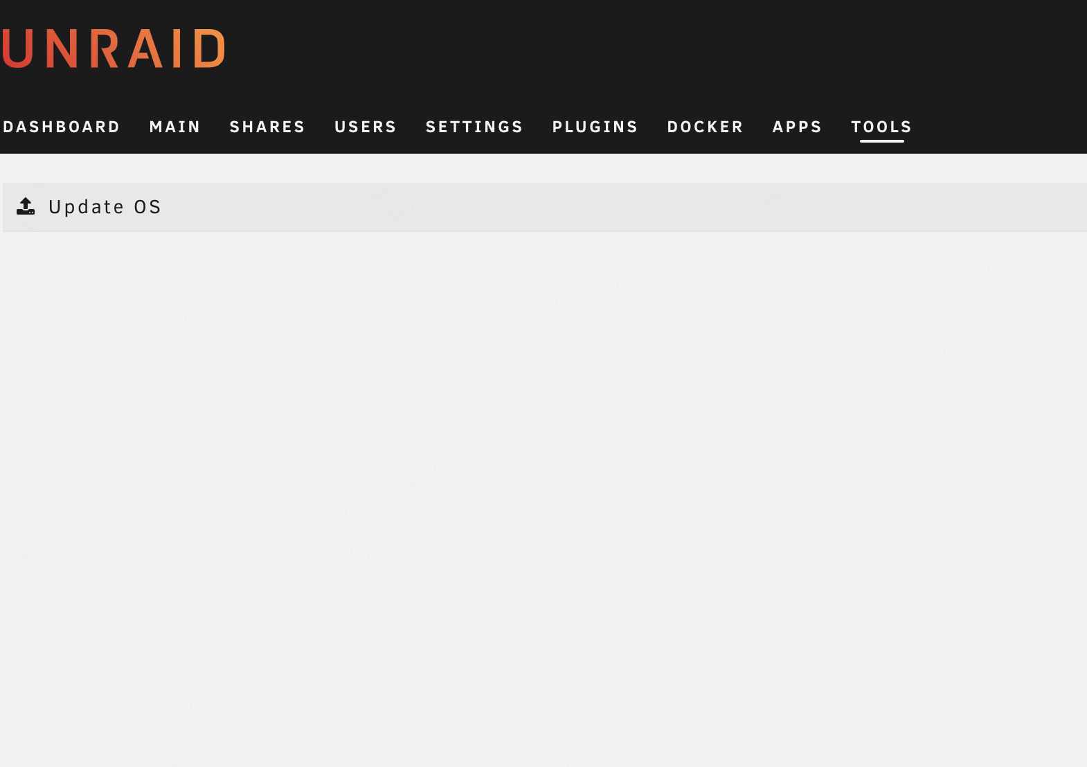

I've lost the system version label after updateing it, and both the update os and downgrade os pages are blank now.
Can anyone tell me what's happening?
image.thumb.png.2e722a09fa66e09e0a03403d21462d53.pngimage.thumb.png.c8026bf29ba1494f973235805501f167.png
Everything went back to normal once I updated the unraid connect plugin and logged back in.

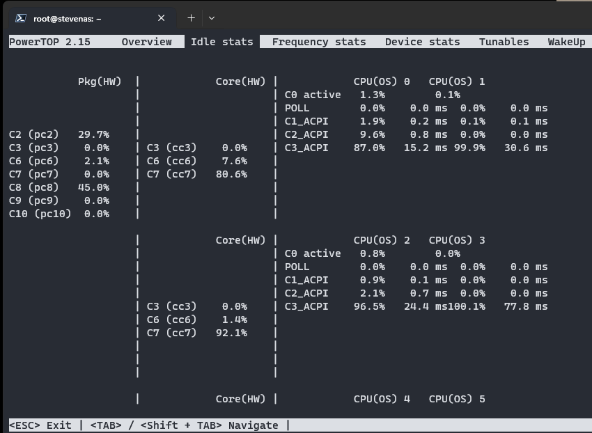

sudo setpci -s 01:00.0 0x80.B=0x42
For at least 2 of my server it worked and the addresses between them are equal but you need to find out the right addresses for your boards by yourself.
1975228384_Bildschirmfoto2024-02-20um10_38_19.thumb.png.26df13e168d895bfba4971ad49cbfe19.png
445218342_Bildschirmfoto2024-02-20um10_39_24.png.2b126d4f9711a43ef531956772c4f464.png
This article may help you (forget the script there, use the explanations how to find the correct adesses): Click Me
If the systems are still stable we will see. I had not enough time to test it in detail. At least I´m in C8 again and don't stuck in C3.
PS: I still expect a clean solution from Limetch with a new Unraid Release.
BEST MAN !!! it Worked, no i can finaly stay updated .. Thx Bro i'am back on C8.. and they just wanted to increase the electric here in Germany..
Please Limetec, put it in the next patch.. for noobies like me its hard to understand what i am doing here.. i was lucky that MPC figuered it out and i just saw this..

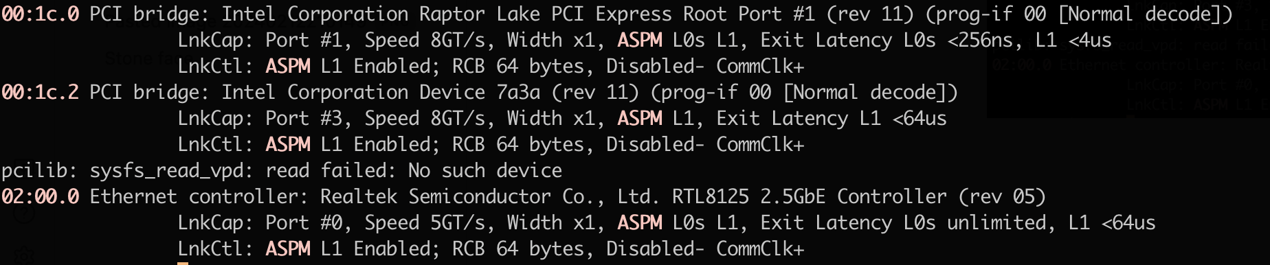

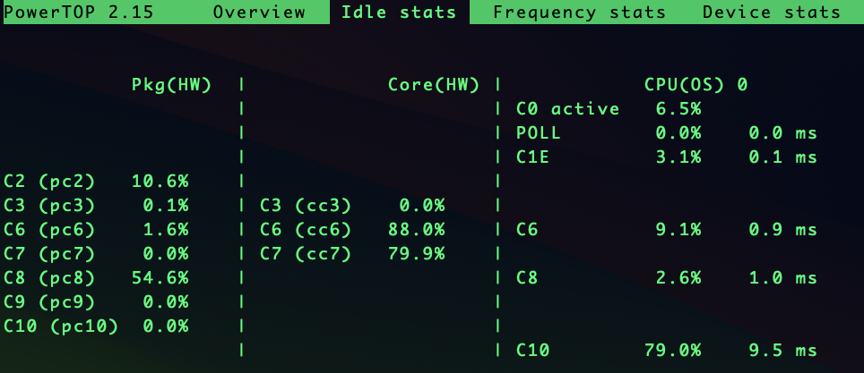

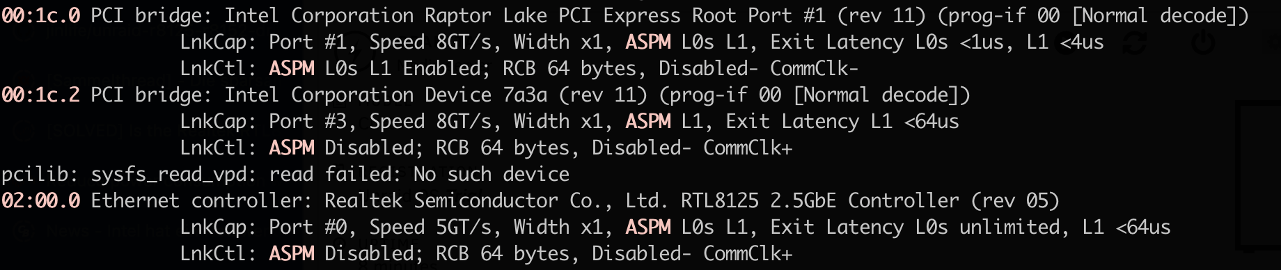

@MPC561, thanks a lot. Your post saved me from returning my hardware I bought recently:
  • Intel i5-12400
  • GIGABYTE B760M GAMING X DDR4
  • Kingston FURY DIMM 32 GB DDR4-3200 (2x16GB)
  • be quiet! Pure Power 12M 550W
This mainboard has the Realtek r8125 NIC. I did some power measurements with Unraid 6.12.8 and applied the hints from the Powertop thread. In the end, the power consumption didn't go below 13W at idle (measured with FRITZ!DECT 200). The pkg c-states were stuck at C3.
I also had the RTL 8125 (B) PCI Drivers package installed.
setpci -s 00:1c.2 0x50.B=0x42
setpci -s 02:00.0 0x80.B=0x42
After executing these commands, nothing changed, still 13W idle power consumption and c-states were stuck at C3.
Then, I uninstalled the RTL 8125 (B) PCI Drivers package and executed the commands from above again, et voilà 7.5W at idle. The c-states reached C10.
Did I do something wrong while the RTL 8125 (B) PCI Drivers package was installed and the setpci commands had no effect?
Are there any disadvantages in not using the dedicated RTL 8125 (B) PCI Drivers package?
The background of these questions is that I want to evaluate if I should keep the mainboard or look for something else with Intel NIC.
