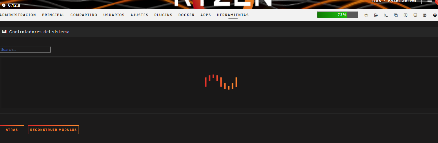

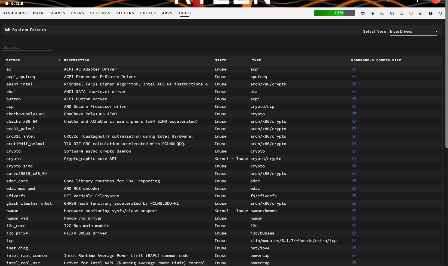

There is a problem with the translation into the Spanish language...
You don't show anything in the system drivers tab:
2118521600_Capturadepantalla2024-03-14160134.thumb.png.8c9047053863a341fe8d845fae070d5e.png
And in English it does work perfectly:
254026998_Capturadepantalla2024-03-14160152.thumb.png.748df64a7bc880f4a5e6ab642c67ab63.png
I have tried on another computer with the 30-day trial license, a completely clean installation and as soon as I install the Spanish language the same thing happens
Thanks, we're looking into it
