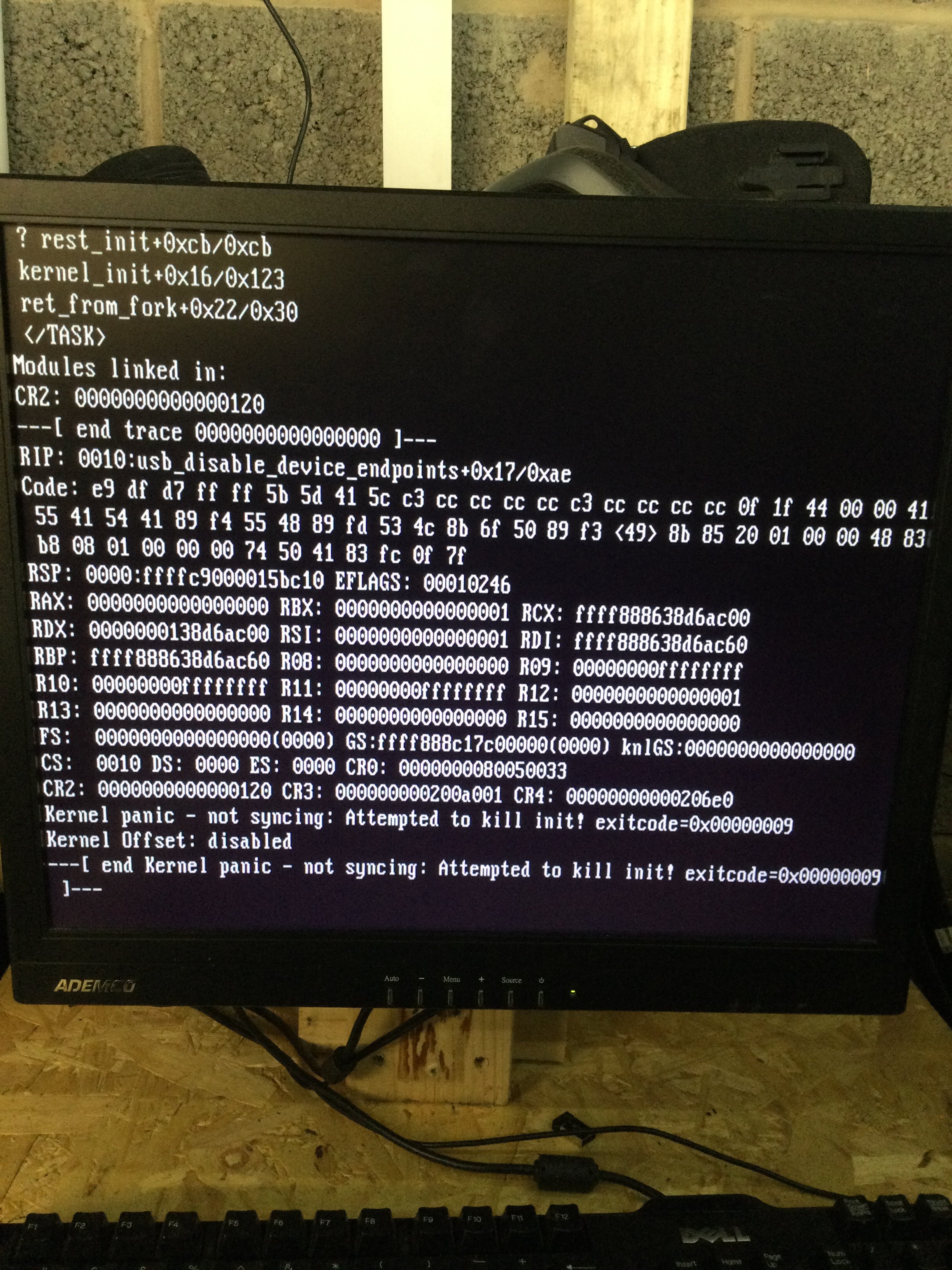

  6. Hi Guys, Here's my problem: I have a Dell R710ii server that I set up Unraid on about 5 years ago, at the time I was with a different ISP and used an Asus router. Due to work, moving house and family commitments this has been powered off for several months, during which time I have changed to a different ISP and now use their router. My issue is that the router does not seem to see the server, the cable is fine and I can connect my laptop and use the network etc. but when I connect into the Dell NIC I get lights flashing but no connection to the router! The router default DHCP range is set from 192.168.1.64 to 192.168.1.253 with the router on 192.168.1.254 the lower IP's are for fixed IP's. My server has a fixed IP of 192.168.1.186 gateway of 192.168.1.254 subnet of 255.255.255.0 and would not connect to the router, I thought it was due to the DHCP range, so I altered the DHCP range minimum from .64 to .200, still no connection with the router!! So I reset to factory on the router and altered the server to .40 and still no joy! Can anyone advise further actions? I'm not totally familiar with networks etc but did get it all working originally at my last property! Thanks for any help/pointers, Mel.
  7. booted into server now ๐Ÿ˜ƒ all sorted! Thank you very much for your assistance, most appreciated ๐Ÿ‘ best regards, Mel.
  8. So I have to go through the set up on the new drive using the GUI and use the backup feature on the dashboard?
  9. yes, it boots on a new drive with the stock install!
  10. Sorry for the delay I've been away with work! Photo attached of error screen:
  11. Hi All, My server stopped responding on the network, I could not access the system at all! I rebooted the server to try to reset it and all I got was "kernel panic - not syncing: Attempted to kill init! exitcode=0x00000009 I have used a backup from my servers to replace the USB drive but the error is still occurring! I am a relative newbie to servers and Unraid so any help would be most appreciated regards, mel.
