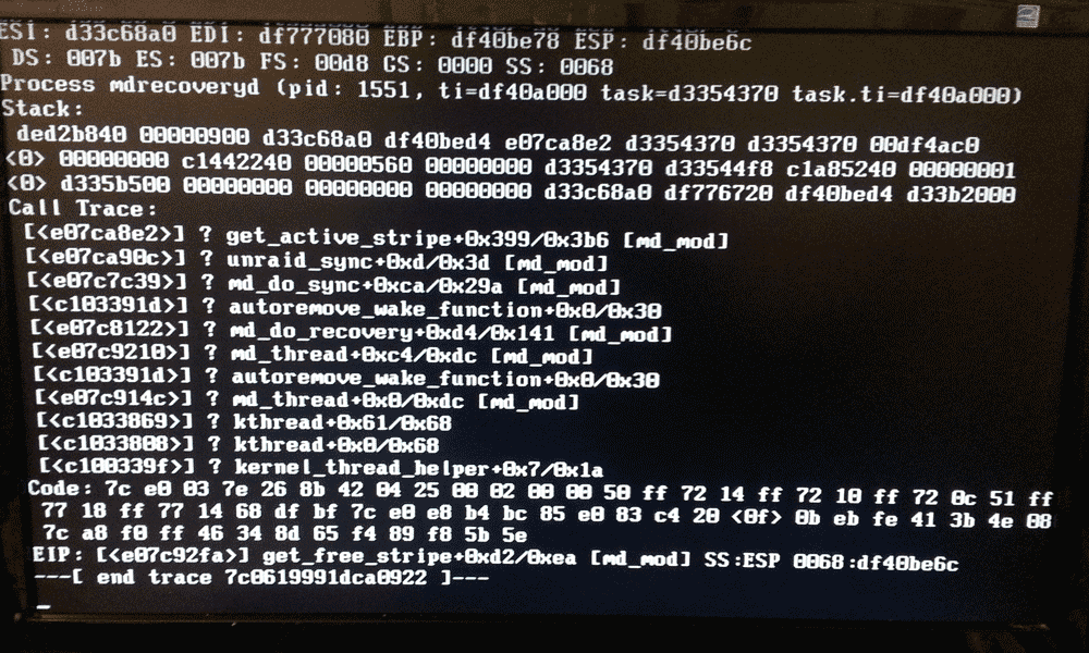

I was doing that and my Server locked up again but this time it's connected to my monitor so I could see if anything was happening. Any idea what all this means and does any it explain why the server becomes unresponsive?
Is the terminal locked-up at this point?
Yeah it was when I took that screenshot. It also locked up just now without all that info, I also now can't access it through the browser.

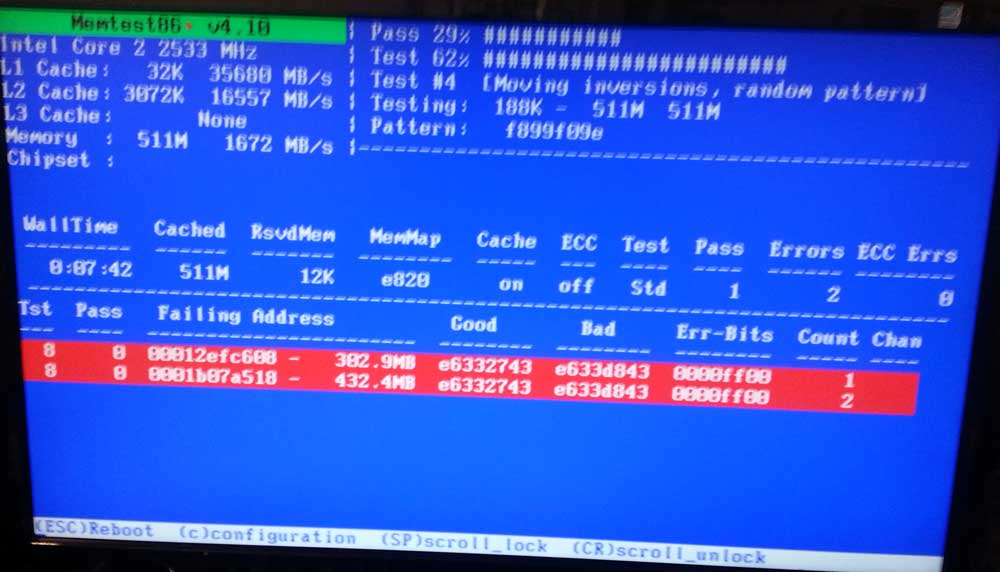

Anyway it only just occurred to me to run memtest as I saw the option there and I think this explains my troubles.
Of course it didn't happen when DDR2 ram is dirt cheap and I'm pretty sure I don't have a spare lying around. :(
Cheers folks.

I wasn't buying 8GB DRR3 for my server just using that as an example of what I paid for the RAM in my main PC and I'm using DDR2 in my Server which is fairly expensive.
Actually, this is a good opportunity to quadruple (or more) the memory in your server  :)
I note from MemTest that you only have 512M of RAM now ... you COULD actually replace that at a pretty low cost:  http://www.scan.co.uk/products/512mb-dane-elec-celenade-ddr2-pc6400-800mhz-240-pin-non-ecc-unbuffered-cas-5-5-5-12-retail
... but I do NOT recommend that.    Get at least 2GB !!
Yeah I've already bought 4GB of DDR2, it's used so it's a bit of a risk but it's less than half the price of new RAM so fingers crossed.
