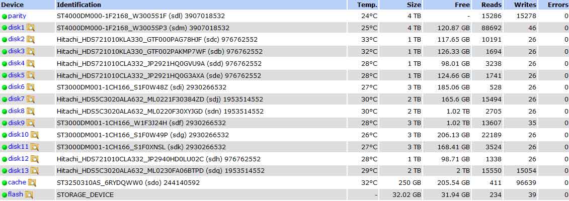

October 17, 201313 yr Author UPDATE: The tweaks didn't do anything for the problem. Would the drives being not insanely loaded with free space still be an issue with a cache drive? Attached is an image of my free space situation if anyone was interested. Is there anything else I can do? UPDATE: I found that moving large amounts of files around on the same share can cause the issue.
October 17, 201313 yr I've seen the problem appear on 1-2TB disks when the free space was in 100-150GB region. Unfortunately I do not have cache disk on my production system, where I have had these issues, so I cannot say for certain whether the data disk fill ratio could affect also cache disk writes. To me it would seem odd if it did since they should be totally isolated until the mover kicks in. Could you temporarily re-arrange the data on the disks so that you had one disk with >300GB free (and others with less than 100GB) and test with it? You could/should use a telnet connection do to this since it might not work over smb. This is the last thing which comes to mind apart from getting a completely new data disk.

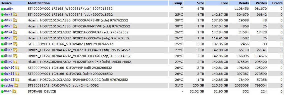

November 13, 201312 yr Author After doing some rearranging and a adding a few drives (for space), the issue still occurs. Free space is not the problem with how much space is available on both the cache drive and a few of the drives in the array. Attached is a current drive listing of my server. I do notice that just before the error occurs when copying files to the server, any reads (playing movie on local system) locks until the error fully times out. I'm still running a 5.0 stock 4GB memory limit, the error occurs without syslog events, the network card had been swapped for an Intel card, still no go. I'm still leaning towards a samba/unraid bug. Is there anything more that I can do to diagnose this? Is there a way to increase logging levels in unraid?
