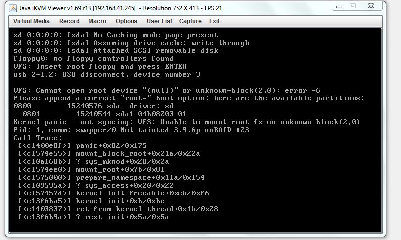

I've been up for a long time until today.  The server will not complete the boot process.  The server starts booting off the USB until I get the message in the attached screenshot.
Any idea of what happened?
Possible corruption on your USB key, stick it in a windows machine and run a chkdsk
