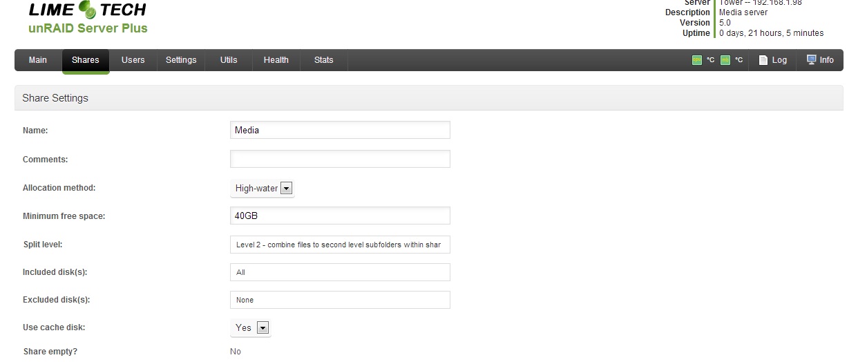

Yes.  Here is a screen shot of one of my share settings.  I know the cache drive is being used when I write to a share because it's the only drive that spins up and I can see the continuous writes on the web gui.  I've tried to read all I can to figure this out.  The thing that is really confusing is why writing directly to the cache drive is so much faster?  I've read somewhere that it would be faster but that much?

Remove SimpleFeatures. It is not compatible.
You may also need to reboot.  In the past changing a share's cache setting, after it was created, has not always applied correctly until a reboot.
And ditto to dgaschk, simple features is not compatible 5.x
