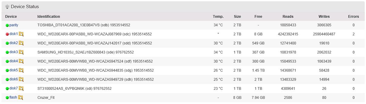

One thing that's weird is the UI shows LOTS of reads and LOTS of writes to just this one drive (image attached). Also, this drive is almost 100% full. I'm HOPING that something tried to write to the drive, but since it's full, threw an error. Though I thought UnRaid handles this gracefully.
What do? Run a parity sync?

Put in a new drive, and let unraid rebuild onto the new drive from the rest of the drives. Unraid is handling it gracefully, it's allowing you to run with one drive failed, and will rebuild the contents on the new drive when you put it in.
It's possible that the drive is still ok, could be power or sata connection, but as of right now, the contents of that physical drive isn't relevant, as unraid has been emulating it using parity ever since a write to it failed.
You can try rebuilding it onto itself, but if I were you, I'd put in a new tested drive, and run diagnostics on the old drive after the array is healthy again.

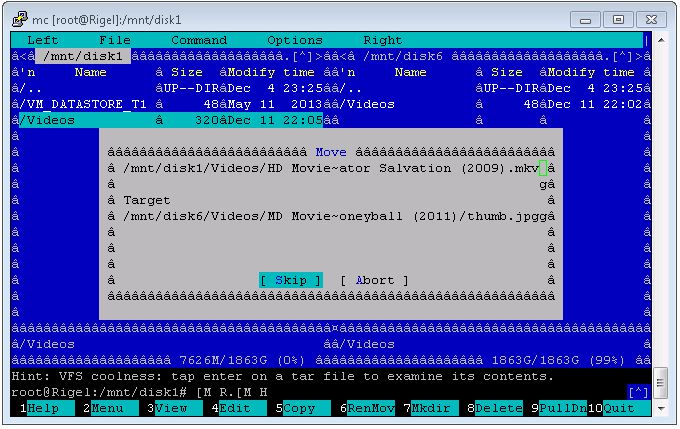

OK so the move appeared to be going VERY well.. .and i think there was only about 60GB left to move over... then i noticed THIS on the console (attached).
basically the file it's copying the source/target doesn't match... it looks like it's moving a .mkv file to a thumbnail?
I think the files got moved over. the free space on disk6 is 8GB, which is what disk1 was at before the fail.
edit: disk1 still shows 548GB in use... why would that be? i did the ren/move option in MC

strange, it repeated that for a bunch of different source files... but should i worry about this? or is it just a display issue?
