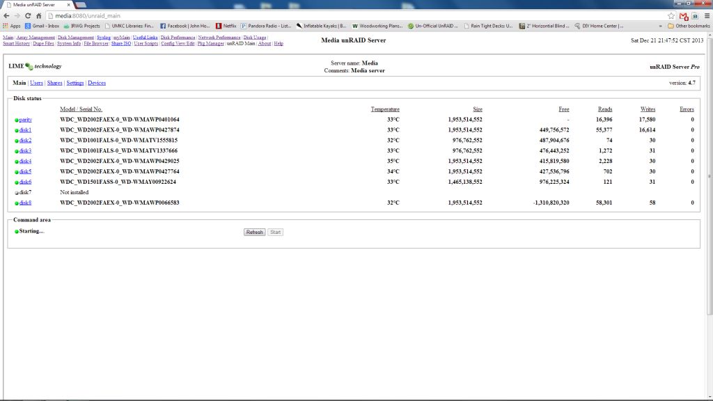

So I know I messed this up but how do I fix it. I removed two 1TB drives because they were on a PCI slot and I'm upgrading them to a PCI express card. However disk 8 was also on the pci card and I moved it to the onboard SATA. In the process I somehow created a duplicate disk of 8. Now it says it is 2TB however the % full is empty and shows negative free space. I think it believes I have 4TB. I know I have around 1TB of data on the drive.

For starters, the serial # for drive #8 indicates that it is indeed a 2TB drive; so it's not clear why you "... think it believes I have 4TB", or why you said you "somehow created a duplicate disk".    Why did you make those statements?
Your configuration also does not match what you've listed in your signature ==> you list 10 drives; but only show 8 in the system.  I presume this is simply an oversight ... or are some of your drives not assigned?

I will add that in your signature you have 5 2TB drives and in your current screen shot there are 5 2TB drives. I think the question garycase is getting at is are you sure this is a 1TB drive vise a 2TB drive as indicated? Although this doesn't answer your question of the reported negative space. Attach a copy of your system log to help isolate problem if the drive is actually reporting incorrectly.
Did you guys even look at his screen shots. It clearly shows -1,3xx,xxx free for disk 8.

Yes, it clearly shows that (a) it's a 2TB drive and (b) it's got a negative value for free space.    But the display also does not match what his listed configuration is; and his description implies it's a 1TB drive (although the serial number shows that it's clearly a 2TB drive).

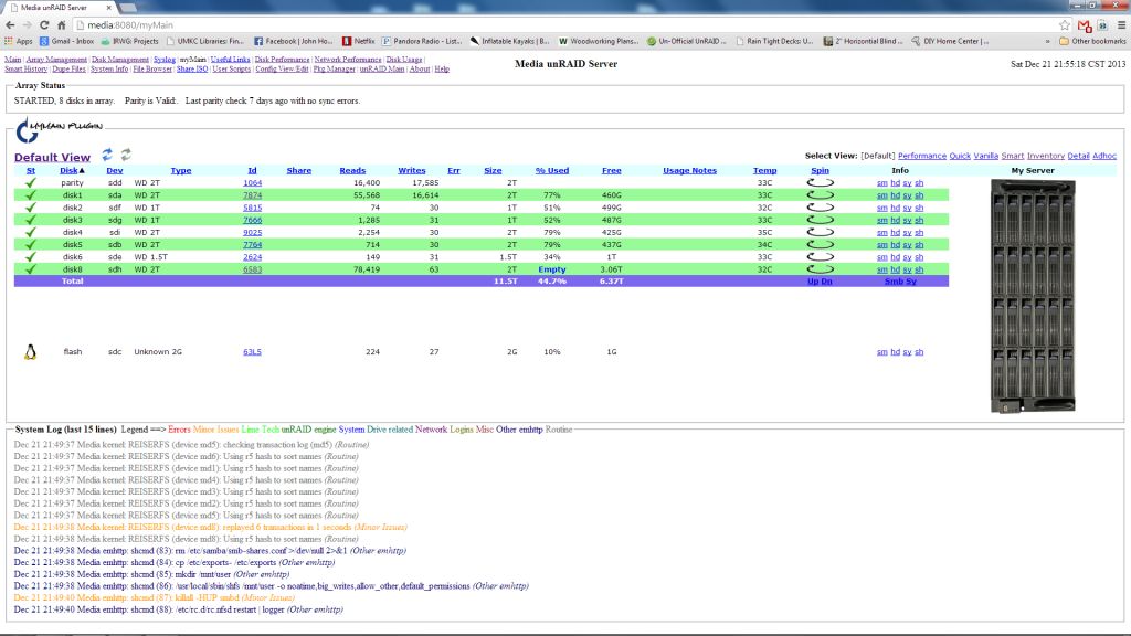

OK so drive 8 is indeed a 2TB drive sorry I did not make that clear in original post. I am also running v4.7 waiting to upgrade to 5 when this is all cleared up. I have looked at my syslog but it just shows me moving a bunch of files off of drive 8. I attached my first 4 syslogs in this email and my next 5 will be in the following email. What do you mean by a newly configured flash drive? I ran the cmd fdisk -l -u /dev/sdh and it shows up as a 2TB drive, but I did get this error Partition1 does not end on cylinder boundary. Not sure how to send that message to a text file if you let me know how I'll do it.
I know I did this to myself. What happened was I had a 1TB and the 2TB (drive in question) on a PCI SATA card. The performance was awful, so I decided to get a new PCIe SATA card. In the meantime I had 2 1TB drives on the system that had nothing on them so I removed those 2 1TB drives and connected the 2TB drive to the motherboard. Now I know how to due this properly by running the setinit cmd, however I of course did not do that first. Under the myMain I removed the 2TB and the 2 1TB drives and then created a new drive with the 2TB serial number, hence why I think it is treating it as if I have 4TB of space on that one drive.

Ok, setting things representing the drives using MyMain will in no way screw up the stock unRAID interface.
How did you get the array working again if you did a bunch of changes in MyMain but didn't run ititconfig to reset the array after you removed the drives?

Joe - unRAID itself is showing a big negative free space on the disk so it can't just be unMENU.
