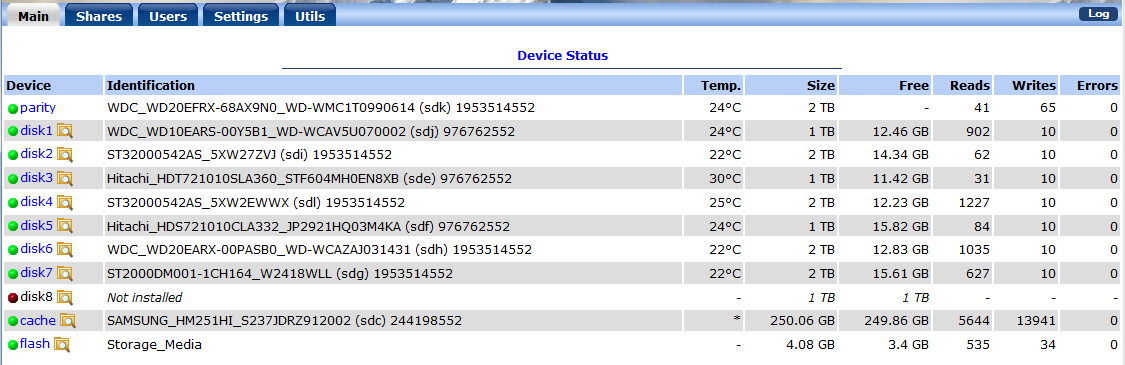

I just finished pre-clearing a new Seagate 1TB drive, added it to my array, restarted & everything looked fine. While I'm fighting issues with preclearing a 3TB drive (intended to be the new parity disk), I figured I'd start moving a few items back to the server (since my first 7 drives have between 11 & 15GB free, each, I'd moved a few files off to free up some room).  Using Windows, I copied a few movies to my 'Movies' share, and got an error indicating that I needed permission to continue.  Assuming that unRAID was going to put the data on the new drive, since I use high-water allocation, I clicked the disk ID in Main and double checked that SMB was set to export & security set to public for the drive. When I clicked Apply, then Done, Main was showing the new disk with a red ball. In the drop-down for disk 8, it showed my 'extra' disk that I mount with SNAP, and it showed the 3TB drive that is being pre-cleared, but it didn't show the 1TB that was part of the array. At this point, I shut down the array and rebooted the server, in the hopes that it would come back up OK. It didn't.
Knowing that there's nothing on this drive, I'm not worried about losing data, so I brought the array down, marked disk 8 as unassigned, and brought it back up. It's now showing disk 8 as not installed with a dark red ball (instead of the bright red it was before) and the array as started, but it has a yellow ball.
Since I'm not worried about losing any data on this disk - it's brand new and hasn't had anything written to it yet - what are my next steps to get the array status back to green, then to trouble shoot why the disk went red? At this point, since there is so little space left on my array, I'm not writing anything to it, either, just reading from it.

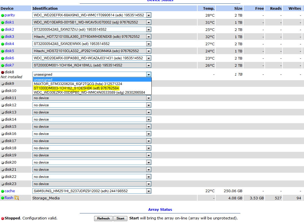

The drive itself is recognized by unRAID, I've attached a screen shot with it highlighted for disk 8, it just won't come up at this point.
