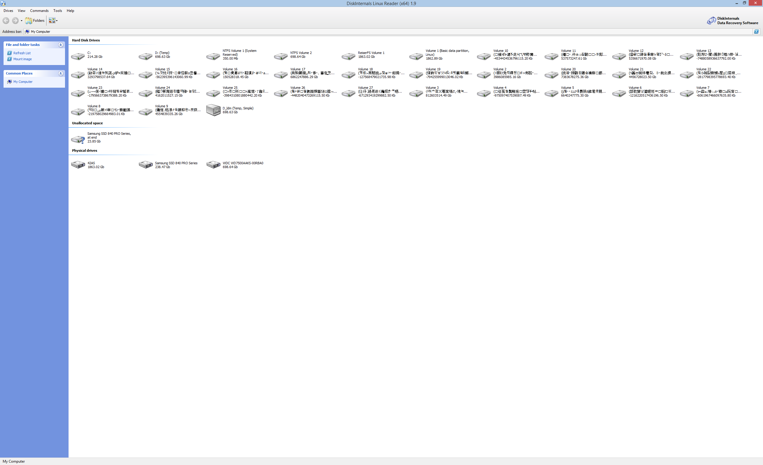

I think it is my disk 3 going bad. I pulled all the drives and tested them in windows with the linux reader program and all of them opened and I could see the ReiserFS, but disk 3 had other volumes with all chinese/japanese characters. All other disks just had the reiserfs. I started unraid without disk 3 and running smart long tests on 1,2,and 4 and so far they are going through without crashing like they do when disk 3 is in. I am going to replace 3 with a spare.  Anyone ever see these weird volumes?

Your Disk 3 has a volume of size greater than 6,000,000,000 Gb.
Is that 6 EXA Bytes? or is it 6 ZETA Bytes?

Yup, I took it out and put another 2tb in its place. Unraid did its thing to recover. I still do not know why when one of my drives goes bad it tries to affect a few of the other drives on the same sas connector.
