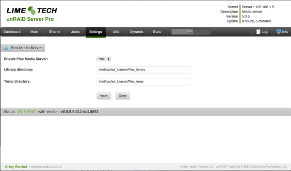

Is your plex running on the same server as plexwatch?
Attaching config.pl and a screenshot.
Yep (screenshot attached).
Okay edit config.pl and set server IP to localhost
Then run /mnt/cache/_Usenet/appdata/plexWatch/plexWatch.pl and start playing something on plex then run plexWatch.pl -watching

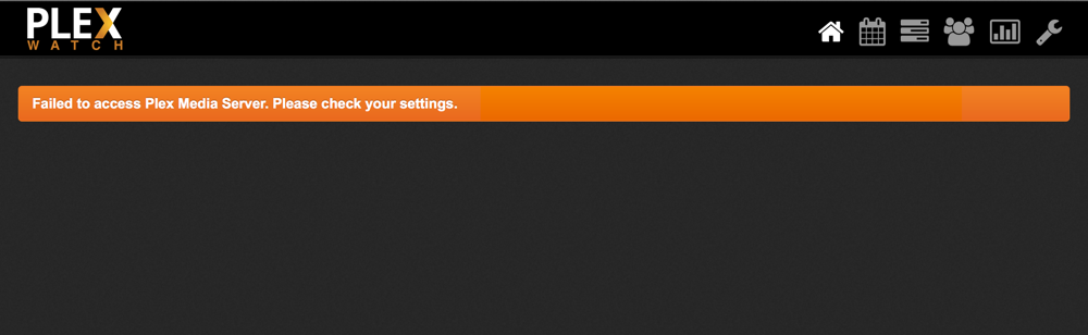

plexWatch still gives the same message: Failed to access Plex Media Server. Please check your settings.
When I change config.pl back (from localhost) to IP address, output is the same as above.
