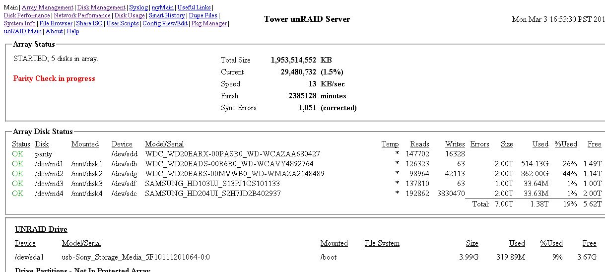

Is a failing disk causing my insanely long Parity check?

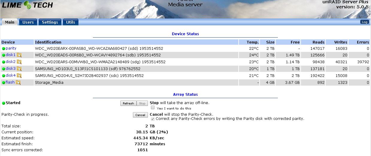

I've added a new 2TB drive (Drive 4 in attached screenshot) to my existing array in order to replace a failing drive (drive 2), the array however is recognizing all drives and rebuilding Parity which is estimated to take around 2 months at the current rate (445K/sec).
Is the failing drive causing this and if so, do I just pull it from the system and if I do that, how do I get the disk 2 rebuilt on to disk4?
Thanks!

So unRAID scanned the new drive and then got me to format it  and then added it to the array, should I just cancel the parity sync and see if I can copy the data off disk 2 or do I need to get another 2TB drive and then pull disk 2 from the array and get it's content rebuilt from the parity drive?
Thanks for your help.

I didn't pre-clear, just stuck the new drive in the server, it asked me to let it scan the drive which I agreed and then asked to format which I also agreed, I don't remember being asked to start the parity check but the server has been switched off for quite a while so maybe it's the monthly parity check job that started it off?
Should I cancel the parity sync and start a filesystem repair on drive 2?
