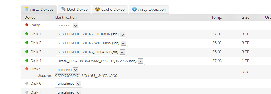

It has been a couple of weeks with no issues. I come home today to a red ball on the parity and another disk. I have attached a syslog and screenshot of the red ball status. The server is shut down at this time because I don't know what to do.  The syslog was too big so I zipped it. I hope this works. I would appreciate it if someone would guide me as I am lost.

It appears your parity disk has been dropped from the array (it is showing as removed) and the data disk with the red ball is not being found connected to the server.  Not sure if the parity disk might actually be ok but just removed from the array? You could drop down one of the drive slots to see if the parity drive is there or not.
