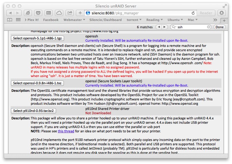

connection refused means that either your unraid dont open that port (openssh is not installed) or firewall blocking. Have you try look at the unmenu package again? it seems that openssh package wont be re-install upon reboot without some tweak.

got this on your package manager?
Thanks! I don't have unmenu installed but I will install it.
