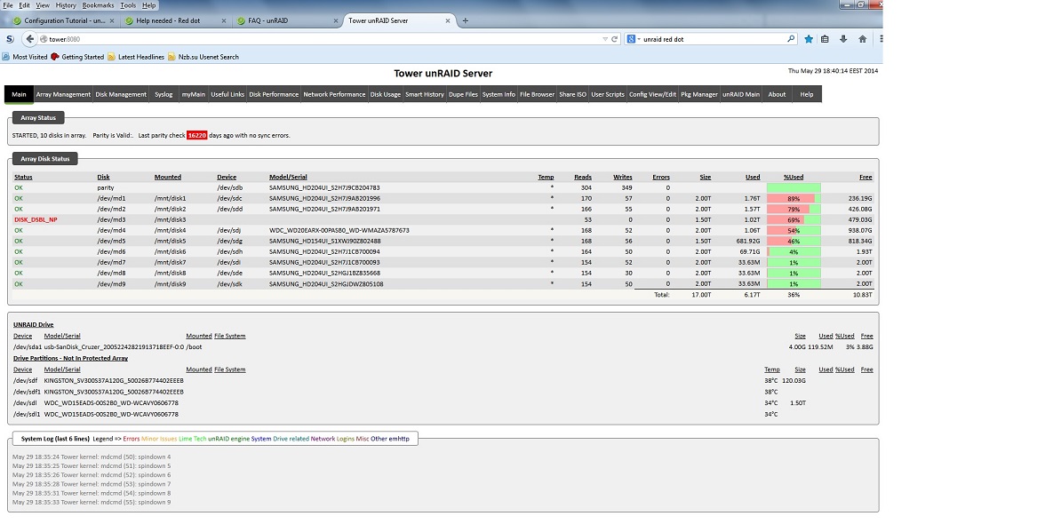

Hi Guys,
I got myself an SSD drive yesterday and once installed, I decided to add 3 more drives in the array. When the drives started formatting after I run 3 rounds of preclear on each, I started closing the case by screwing the screws in the end. Stupid move, as my elbow pressed the power button. Once restarted I got a red dot next to drive 3. I unmounted it and remounted and let the drive rebuilt. As it seems I was not a good move either since I got yet another time the red dot next to the drive.
Now I will have to remove the drive, but given that I just installed the new drives, I have none left. Hence I would need to move one of the new drives (they are totally empty), into the place of the 3rd drive. Could someone guide me on how to do it, since I believe, if I just unassign the drive, this means that 2 drives will be missing?
Attached syslog and printscreen. I am using version 5.0.5
Thanks in advance for all the help!
syslog.txt
Screenshot attached.
