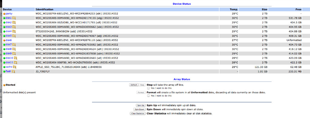

Unraid reported /md6 as failed. So I installed a new disk and ran preclear. When I added it to the array the disk showed as unformatted. Therefore I tried to format it to try to get UR to accept the disk.
I would say the disk is bad but it precleared just fine.

Do you actually have a redball on disk6? I'm not sure unRAID will even let you add a disk to a compromised array, but you should be able to replace a failed disk.
Post a screenshot.
How were you trying to add it to the array?  By stopping the array, going to the failed disk, and assigning the new disk (via the dropdown)?

Please post a screenshot.
I updated my post with a screenshot. I don't care about disk6 at all as I was able to dropped the "failed" disk into a linux machine and pull all the data off of it. The parity can be reitialized as well.
