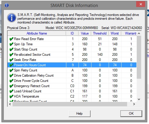

July 18, 201412 yr Help disk 4 when disabled again with 4 write errors and I can't find anything wrong with, also there is nothing on the disk yet. It is running on a brand new LSI 9211-8i and cables, last time it went disabled it was on a different 9211-8i and cables. Since I had nothing on disk 4 yet I removed the drive from array using new config and started a parity sync, I had already started a preclear of a new refurb drive I just got back a few hours early, and I started testing disk 4 using WD disk tool. The WD disk tool has completed both short and extended test successfully. Test Option: QUICK TEST Model Number: WDC WD30EZRX-00MMMB0 Unit Serial Number: WD-WCAWZ1424060 Firmware Number: 80.00A80 Capacity: 3000.59 GB SMART Status: PASS Test Result: PASS Test Time: 01:22:26, July 18, 2014 Test Option: EXTENDED TEST Model Number: WDC WD30EZRX-00MMMB0 Unit Serial Number: WD-WCAWZ1424060 Firmware Number: 80.00A80 Capacity: 3000.59 GB SMART Status: PASS Test Result: PASS Test Time: 09:49:21, July 18, 2014 I am uploading a syslog that I had to edit to get size down but I only deleted successful movers and a bunch of duplicate stuff at the end. I am also getting this error in the command prompt. REISERFS abort (divice mdq): Journal wite error in flush_commit_list REISERFS abort (device md2): Journal write error in flush_commit_list Looking at these errors it seems to be on my parity disk and disk 2 according to the log. but these might be because I pulled a few disks out to test if they were properly spundown. My last LSI card was not flashed to IT mode and was not spinning down disks even though the web interface said they were. So this new card I flashed to IT and I wanted to know if the disks were actually spundown. This is the system that I am running it on. According to my UPS I am running at 270 watts and this is between my server and main desktop. This is with my server running a parity check with 5 disks, and 1 disk preclearing. OS: ESXi 5.5 on SSD unRAID: 5.0.5 Power supply: 650w Seasonic with a single 12v Rail Hard Disks: 7 red and green WD drives on LSI 9211-8i syslog.zip

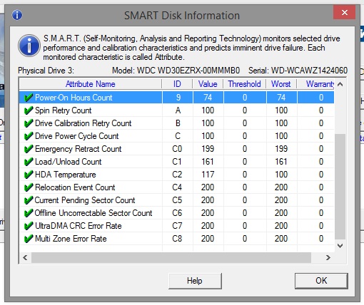

July 18, 201412 yr Author Here is the other half of the smart info. I couldn't add it to the other post.
