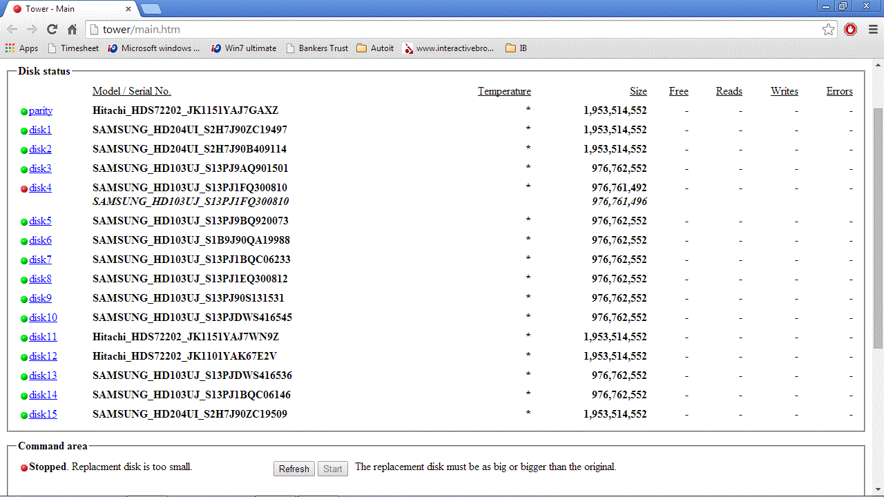

August 6, 201412 yr Help, in working towards upgrading to V5 from V4.3.3 I was upgrading to the first step of V4.7 I copied the two bz files and memtest and rebooted the server (15 drives + Parity with no drive changes) and V4.7 installed. But the array didn't start because it reports my disk4 (SDO 1TB) as red because "my replacement disk is to small" No disk was altered or changed. Just upgrade to V4.7 from V4.3.3. I do notice that the total overall size is 4 blocks less under V4.7 V4.3.3 see's it as 976,761,496 and V4.7 see's it as 976,761,492 I don't see any HFA issues in the syslog for this drive. Just a "Wrong" line added. Before the upgrade the array was all happy with no errors. If I revert back to V4.3.3 the array starts. Best solution/steps to get this working ? Thanks for any help. SOLUTION: Installed directly to V5.0.5 bypassing the recommended install to V4.7 first before going on to V5.0.5. V4.7 showed 4 blocks less on one drive so array would not start. However V5.0.5 showed the original 4.3.3 reported size. Steps: Saved my old 4.3.3 disk mappings and remapped them under V5.0.5 except the parity drive. Checked that all drives didn't have any MBR issues before starting the array. Started the array (without a parity drive!) Run the UTIL "New Permissions" Stopped the array Added my parity drive (new 4TB from old 2TB drive) Let parity get created on new drive. All happy 15 green drives + parity. Syslog.txt

August 11, 201412 yr Author If you go back to 4.3.3 is all ok? Yes, going back to 4.3.3 and everything is fine and the array starts. I wouldn't think it would be off sector wise since it's just a change of four bytes! Emailed Tom but haven't heard back if it's ok to jump to 5.0.x from 4.3.3 directly.

August 11, 201412 yr When did you last run a parity check on this system? ... and was it error-free? (Zero sync errors and no disk errors shown) I vaguely remember this size issue being a "hiccup" along the way to v4.7, but it's been too long for my ageing memory to remember exactly what the resolution was ... ... but not so long ago that a quick search through the forum couldn't find it Here's the same issue back when v4.7 was released: http://lime-technology.com/forum/index.php?topic=10483.msg99685#msg99685 ... and the very next post by JoeL provides the fix: http://lime-technology.com/forum/index.php?topic=10483.msg99686#msg99686 In your case it would be hdparm -N p976761496 /dev/sdf

August 12, 201412 yr Agree ... as I noted above, the best folks to comment on this are Tom or Joe But a few more thoughts ... There were quite a few folks who had a size issue when migrating from 4.x (where x < 7) to 4.7 -- the thread I referenced above has at least a dozen examples of that (I quit counting/reading after 15 pages or so). Note that several of these had the same 4 block differential that you're seeing ... with fixes that weren't always identical. Tom made a couple posts on this on page 10 in the thread ... basically just noting that he was considering ways to alter the handling of drives with this issue -- but there was never a follow-up release in the v4 series. Most of the posts advising folks how to resolve the issue were from JoeL. If you want to keep all your current configuration data, wait until you get the guidance you need to successfully upgrade to v4.7 (or carefully follow the guidance that was provided 3 years ago in that thread). But note that a lot of the older plugins/addons aren't going to work with v5 anyway. By the way, I just noticed (in reviewing the thread) that you said your drives were only different by 4 bytes. That's not correct -- they're different by 4 blocks. AND this IS almost certainly an HPA issue. The drive sizes in question on the troublesome drive are 976,761,496 (shown in 4.3) and 976,761,492 (shown in 4.7 as "too small"). Note that the CORRECT size for this drive without an HPA is 976,762,552 Personally, I'd just upgrade directly to v5.0.5 by starting with a fresh install of UnRAID, as bkastner and I suggested earlier. If you're concerned about whether or not this may cause issues with your current data, there's a simple way to safely check this ==> Create a new USB flash drive with a clean v5.0.5 basic (free) install. Boot your system with that flash drive. Then add the troublesome drive (SN S13PJ1FQ300810) as the ONLY data drive ... with no parity. Confirm that it doesn't show that drive as "Unformatted" (Do NOT Start the array if it does). Then just Start the array, and you can then access the drive from a PC to confirm the data is all there. Do NOT do any writes to it, so it's not modified by this test. As long as everything's okay with that, you can safely do as outlined earlier to just move directly to v5.0.5. There is NO reason to remove the HPA from the drive ... the amount of missing space is insignificant.
August 12, 201412 yr Ok - went back to twilight's syslog. Sure enough, there is an HPA on disk4. (sorry gary, how could I have doubted you ) Still doesn't make sense to me. If there is an HPA, then I would think that all versions of unRAID would see the disk as the smaller size, and if the array was created when the disk was larger, report a size error - be it 4.3, 4.7 5.0.5, or beyond. But maybe 4.7 put in an additional check that was not in place for prior versions. Not sure. I do not think jumping to a later version (e.g., 5.0.5) would fix this problem. The HPA would remain. Quick digression - What is an HPA? An HPA is a small amount of disk space that is reserved on the disk, effectively making the disk smaller. The extra space is typically used for a very special purpose (for example keeping a backing of the BIOS settings). An HPA will not cause any harm if it was created BEFORE the disk is used in the array. What has happened (apparently) is that the disk was added to the array when it was full sized, and AFTERWARDS the HPA was added. Since the HPA effectively reduces the size of the disk, unRAID now thinks the disk is too small and it complains. In such a case you might think that you could just rebuild onto the disk leaving the HPA in place - but the problem is the disk is a tiny bit too small and unRAID will not rebuild onto a smaller disk. So the solution is to get a new disk or remove the HPA so that unRAID will see the disk as sufficiently large and allow you to rebuild on it. Twilight - are you using a gigabyte motherboard, or did you use a gigabyte motherboard with this disk at some point in the past? If you are currently using one, you need to do some research and disable the setting that causes the BIOS to create the HPA. Otherwise, removing it will just result in it being created again (or possibly worse cause it to happen on a different disk, which would be very serious in the current situation). Until this is done do not try to remove the HPA. If the disk used to be on a Gigabyte MB, but you have upgraded, the HPA will not be recreated and it will be safe to just remove it. Realize that once an HPA is created it is created and will not go away without it being manually deleted. The goal is to delete it and not have it recreated by the motherboard. Another digression - you might think that telling the BIOS to not create the HPA is sufficient, but it is not. If the BIOS defaults to having the HPA created, then if the battery dies or you ever tell the motherboard to load default settings, the setting will be reverted to CREATING it again, and poof, fast as you can reboot, an HPA will be created. I believe that Gigabyte updated the BIOS of at least some motherboard such that this is NOT the default. This is really what you want as your long term solution. Doing the following will not remove the HPA and can be safely done while you investigate. But you need to turn off the HPA creation before doing the actual removal - for which I will post instructions after you do the following. Run the following command (boot into 4.7 first) hdparm -N /dev/sdo Post the output and await further instructions.

August 12, 201412 yr Still doesn't make sense to me. If there is an HPA, then I would think that all versions of unRAID would see the disk as the smaller size, and if the array was created when the disk was larger, report a size error - be it 4.3, 4.7 5.0.5, or beyond. But maybe 4.7 put in an additional check that was not in place for prior versions. I agree ... but clearly v4.7 made a change that caused this problem for a LOT of folks -- sometimes with a 4 block differential (as here); other times with some other difference; but it caused a lot of headaches. The thread I referenced earlier shows a LOT of examples of this -- and the hassle of resolving it (which, if not done properly, could cause data loss). There are 28 pages of comments in that thread, with at least a dozen cases of this issue ... and it's not the only thread that discussed this specific problem. http://lime-technology.com/forum/index.php?topic=10483.msg99518#msg99518 That's why I think the simplest way to resolve this is to just do a "clean" install of v5.0.5 and not bother with removing the HPA. I do not think jumping to a later version (e.g., 5.0.5) would fix this problem. The HPA would remain. Yes, the HPA would remain. But the simple fact is that's not an issue. All it means is that the one disk with this "problem" would be slightly smaller than other disks of the same native size. The only time an HPA is actually a real "problem" is if it happens to be on your parity disk. I do NOT think there is ANY data loss risk by moving directly to v5.0.5, but if there are no backups available, and the OP wants to be absolutely certain of that, the steps I outlined in my previous post provide several ways to be confident of that.
August 13, 201412 yr Author By the way, I just noticed (in reviewing the thread) that you said your drives were only different by 4 bytes. That's not correct -- they're different by 4 blocks. AND this IS almost certainly an HPA issue. The drive sizes in question on the troublesome drive are 976,761,496 (shown in 4.3) and 976,761,492 (shown in 4.7 as "too small"). Note that the CORRECT size for this drive without an HPA is 976,762,552 Personally, I'd just upgrade directly to v5.0.5 ...... Interesting, there is a HPA entry but it's for a different drive (2TB) drive that reports the same between 4.3 and 4.7. The drive causing issues (#4 - SDO) was reporting less under 4.3 and 4 bytes less than that under 4.7 (I don't think it reports a HPA issue in the log for drive SDO). I like the idea of making a 5.0.5 key and seeing if Disk4 is recoginized ok as a precheck.
