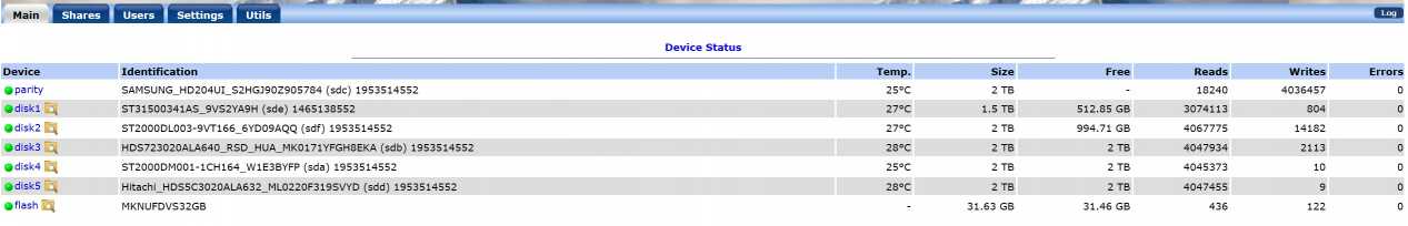

The first shows my main page and the disks that I currently have in my array.  I have a parity disk, 5 data disks, and the flash drive. I added these one at a time in stages.

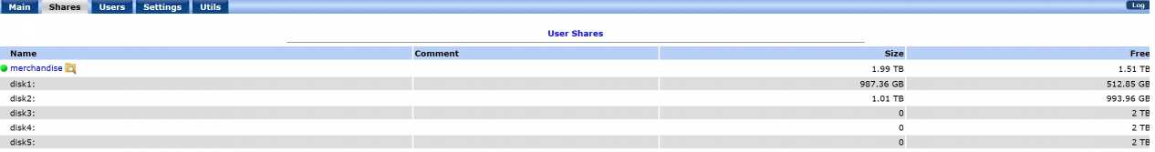

The second screenshot shows the main shares screen for my share named "merchandise".  I created the "merchandise" directory on all 5 data disks by addressing each one directly from my desktop over the network (e.g. \\[iP of my unRAID box]\disk1 -- created my "merchandise" directory, and then repeated for the remaining disks, e.g. \\[iP of unRAID box]\disk2  , then disk3, etc)

The forth screenshot shows what happens if I click in and browse my "merchandise" share from the unRAID GUI.  There is a sub directory called "jdl" that is about 1.8 TB of data that only ever allocated to disk1,2.  After I blanked out the "included disks" section of the share settings, and copied new data from a directory called "Richard", you can see that the disk that the "Richard" directory is on is disk2 still.  I would expect it on disk3 or another disk that has more free capacity (i.e. other than disk1 or disk2).
