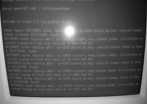

I started noticing these REISERFS messages popping up on the server console.
I took a photo of the screen (UnRaid Server Message1.jpg)

It appears you had a hard crash. The syslog also shows that your flash is corrupted. I am not sure what happened.
From your photograph, I believe that there are issues with the OS (or more specifically the Reiser file system driver) talking to the drive. This has resulted in disk corruption.

So I went and took care of some chores and checked back at the console. And yes, there were a bunch of REISERFS errors.  >:( >:(

Then I checked the console.
REISERFS errors all over again
