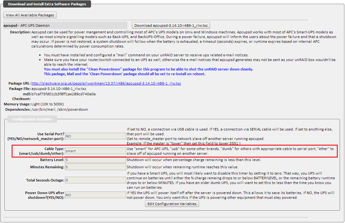

August 15, 201412 yr It seems that the apcupsd - APC UPS Daemon may support UPS of other brands. Can it? There is a description Under Cable Type:(smart/usb/dumb/ether): Use "smart" for APC UPS, "usb" for some other brands, "dumb" for others with appropriate cable to serial port, "ether" to slave off of apcupsd running on another server. I'm considering buying one of these to try out: http://www.prolink2u.com/new/products/index.php?cid=374 I know APC is the recommended brand, but because it forces me to use male/female PSU connectors instead of the regular power plugs (I need a 90-degree one, as my server needs to be close to a wall), the Prolink seems more attractive.
August 15, 201412 yr Can't say for sure, but I do know that the APC UPS daemon supports many other brands besides APC. Personally I've used it with APC, CyberPower, and Belkin ... and others have used a few other models. Since the basic UPS communications protocol is fairly standard, I suspect the ProLink will work just fine with the APS control package in UnRAID ... but the only way to absolutely confirm that is to just try it.
August 15, 201412 yr Author Can't say for sure, but I do know that the APC UPS daemon supports many other brands besides APC. Personally I've used it with APC, CyberPower, and Belkin ... and others have used a few other models. Since the basic UPS communications protocol is fairly standard, I suspect the ProLink will work just fine with the APS control package in UnRAID ... but the only way to absolutely confirm that is to just try it. Oh? Its a standard protocol? Ahhh, yeah it should work then... I think I'm gonna give it a shot. Heh thanks!!
