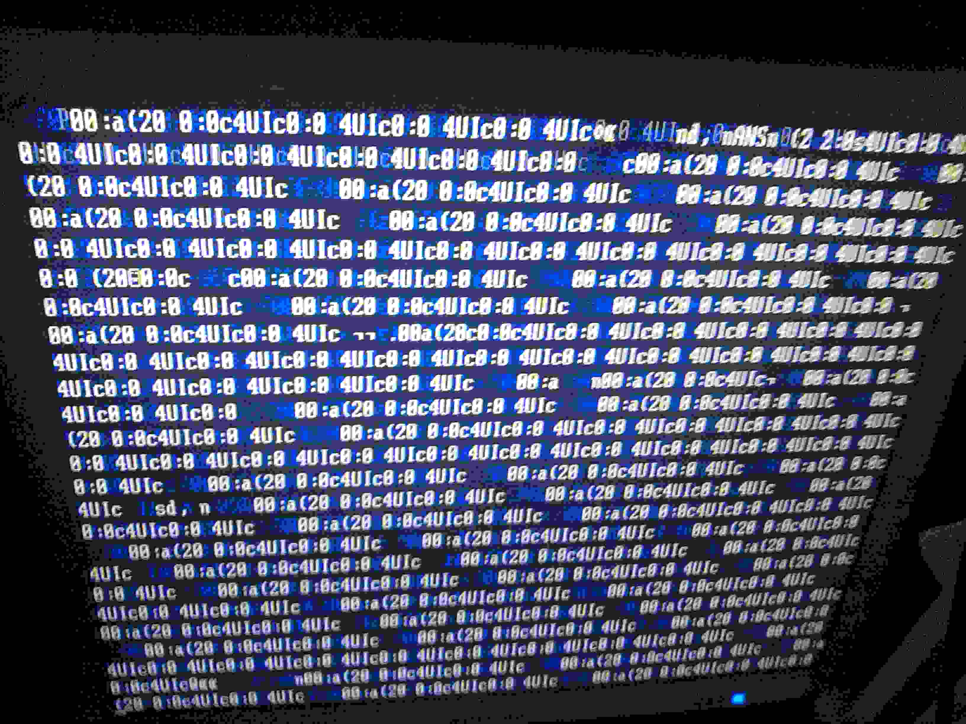

August 26, 201412 yr You have only 4GB memory, any chance you can increase that? The screenshot doesn't show anything useful. When it crashes is this what spews out every time? How about at the very beginning - possible to catch that?
August 26, 201412 yr Author So far I have not more RAM available at home. But I wanted to increase RAM when VMs and Dockers are running fine. So if it helps to find the error, I can buy them now. why not. When it crashes their is either a freeze of the current Screen, or the Screenshot. Whereby the letters and the blue letters change fast. I'm not able to catch what happens right before, but as far es I see, there is absolute nothing before that indicates an error will occur. Did a shh session tail -f /var/log/syslog -> no error relevant output. And the rest I already posted. So do you have any other things to test for me?
