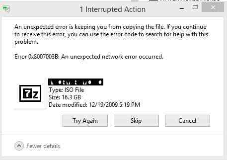

I tried to copy a 16G file from one disk share to another disk share using Samba. The destination was almost full. I was using Windows 8.1 File Explorer.
The server was recently rebooted and all disks were spun up.
The copy dialog sat there at 0% copied for a very long time - I'd say a minute or even longer, before giving an error  (see image below - note the file name is masked).
I had noticed, about 20 seconds or so waiting for the copy to start, that the file explorer window that was displaying the source disk of the file i was copying was having trouble refreshing (the path field started filling with green from left to right). I refreshed the WebGUI to see if the server was unresponsive and it responded quickly while this copy delay was occurring and the file explorer window continued to try to refresh.
Nothing in the log.
After I got the message I tried it again. This time there was a short delay maybe 5-10 seconds, and the copy began and completed without issue. It did ask if I wanted to overwrite the file (the file didn't exist on the disk before I initiated the copy the first time).
This kind of behavior has been occurring going back to sometime during the 5.0 betas I think, and has happened on multiple different servers / motherboards, and using various flavors of Windows from XP to Windows 8.1.  I have noticed that this problem tends to happen and get worse especially with bigger disks and when the destination disk becomes fuller.
I do not have any problem coping files between disks - even to near full disks - when doing the operations on the server (cp/mv).

I was copying from a disk share to a disk share. (//tower/disk5 to //tower/disk4). Both of the disks are in the same user share, but that user share was not being accessed at the time.
The delay was in starting the copy, not doing the copy (once it started the copy fluctuated from maybe 15 MB/sec to 75 MB/sec, averaging maybe 25 or 30 - no complaints there.) Wondering if Samba is trying to pre-allocate the space for the copy and maybe RFS is taking a while to hunt up the blocks on the disk? But that doesn't explain why it would kick off relatively fast when I tried it a second time.
