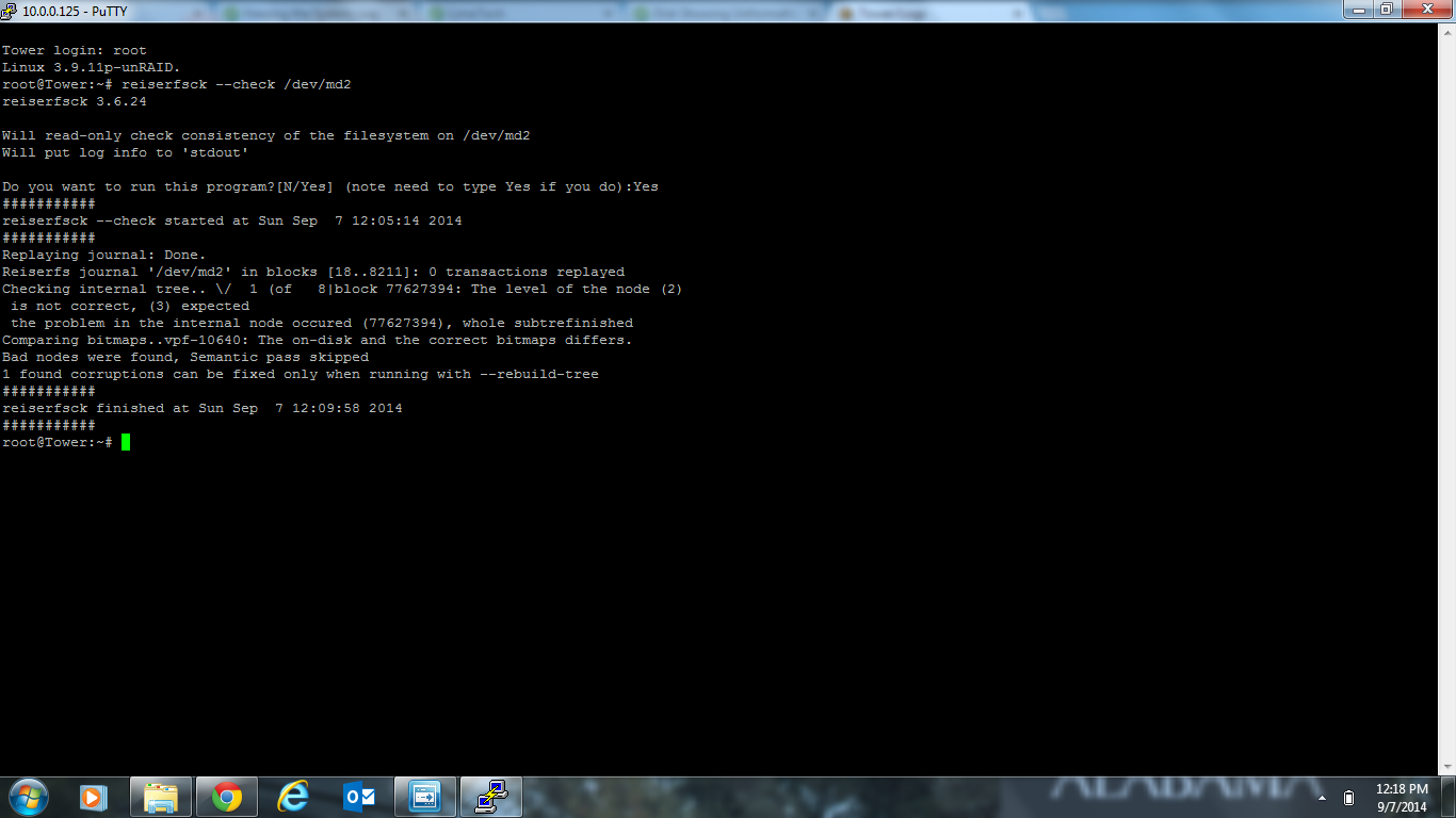

I ran reiserfsck as recommended.  Attached is the output from running that command.  Recommended next steps?
The good news is that the reiserfsck appeared to be able to access the disk fine, and it looks like corruption WAS detected (which is consistent with it showing up as unformatted0.  I would suggest that you take the recommended action.  This will run for some time (it takes even longer than the check you have already run).
