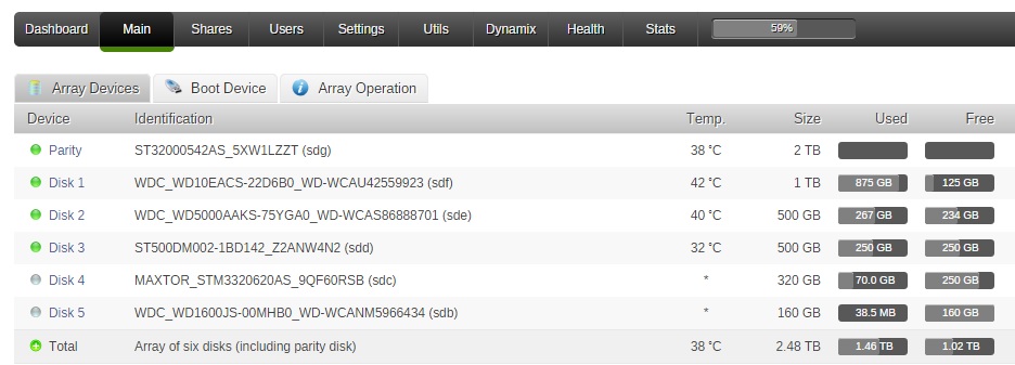

I've read a bunch of the DS380 threads, and just finished a system in one.  Temps are not good.
I've got older drives in there, but the hottest drive is a WD Green, which I would have hoped would run a LOT cooler.  In my old case (an ammo can) with kludged fans, temps were barely above 30C for all drives.  The drive temps shown in the attachment are during an rsync copy operation; I want to run a parity check but with temps like this, a 12-14 hour parity check scares me just a little.

Those temps aren't really all that bad during a fairly active set of disk I/O.    A parity check shouldn't be notably worse; and temps in the low-to-mid 40's are "okay" ... not as low as I'd like to see, but not dangerous to the drives.
You're correct that WD Reds will run a bit cooler -- my array never gets above the high 30's during parity checks (with a Lian-Li PC-Q25B case).    But the drives are spec'd up to 60, so running in the mid-40's isn't a major issue.
Run your parity check and see how the temps do ... as long as drives never hit 50, you're okay (with the possible exception of the Maxtor, which I gather may exceed that.    If it indeed is running over 50, I'd be inclined to replace the drive (sooner rather than later -- no reason to wait for it to fail).  Note that running hot is a key early sign of drive failure.
