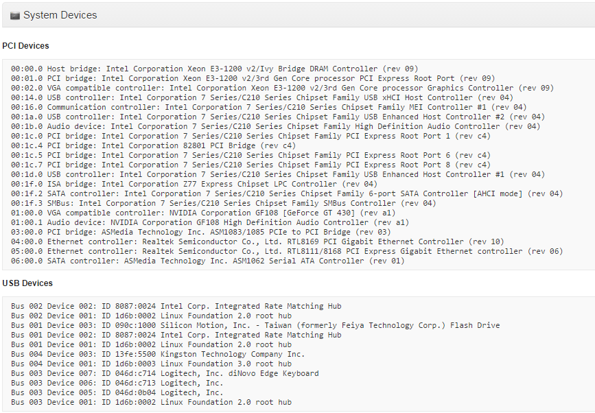

Can you post a printout of what shows up under the PCI devices section of the web GUI?  Goto tools -> system devices and you'll see that. Do the same for you USB devices as well please...
Thanks for all of the info!
Attached is a pic of the system devices.

So I found this stackoverflow question which seems to be trying to tell which pci device is linked to a specific usb port.
So I plugged in a 2nd flash drive (named "Test" instead of "UNRAID") into a port I was hoping to pass thru.
blkid | grep -i test
tells me this is /dev/sdi1
blkid | grep -i unraid
tells me unRAID is /dev/sda1
lspci | grep -i usb
00:14.0 USB controller: Intel Corporation 7 Series/C210 Series Chipset Family USB xHCI Host Controller (rev 04)
00:1a.0 USB controller: Intel Corporation 7 Series/C210 Series Chipset Family USB Enhanced Host Controller #2 (rev 04)
00:1d.0 USB controller: Intel Corporation 7 Series/C210 Series Chipset Family USB Enhanced Host Controller #1 (rev 04)
Shows three usb controllers
Now figure out which is which
ls -al /sys/block/sda
lrwxrwxrwx 1 root root 0 Oct 12 12:34 /sys/block/sda -> ../devices/pci0000:00/0000:00:1a.0/usb1/1-1/1-1.1/1-1.1:1.0/host0/target0:0:0/0:0:0:0/block/sda/
ls -al /sys/block/sdi
lrwxrwxrwx 1 root root 0 Oct  5 03:50 /sys/block/sdi -> ../devices/pci0000:00/0000:00:14.0/usb4/4-2/4-2:1.0/host10/target10:0:0/10:0:0:0/block/sdi/
Looking at the red text (and comparing to lspci output) I can see that unRAID is on a different controller than my "test" usb.  So I can pass thru the usb controller 0000:00:14.0 - the xHCI controller.
I'll post back if it works.  I wanted to post this while it was still fresh.

Interesting!  Definitely want to see if this works for you.  If so, we could put that logic into the webGui in the future to help folks more easily accomplish the same objective.  Thanks for sharing!!
Well, partial success.  The controller shows up in the VM (I have to use remote desktop to check, BTW), but in device manager it is showing up as not having a driver.  Windows can't automatically find drivers.
